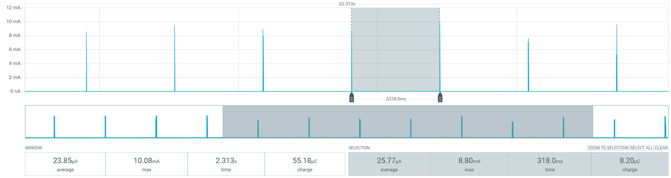

I am power profiling an application on the NRF52 DK. The application uses SPI to communicate with the BMA400 accelerometer:
  1. The program initializes the accelerometer to trigger an interrupt after every 8 samples (at 25 Hz this is 320 ms).
  2. In the ISR, a semaphore is incremented so that a "read sensor" thread will run to read the samples from the sensor.
The code runs without errors (I am using NRF connect sdk V3.0) and I now I am trying to reduce the idle power consumption.
I use the PPK2 to profile the NRF52 DK in Ampere Meter mode. I see the following plot with spikes every ~320 ms as expected:

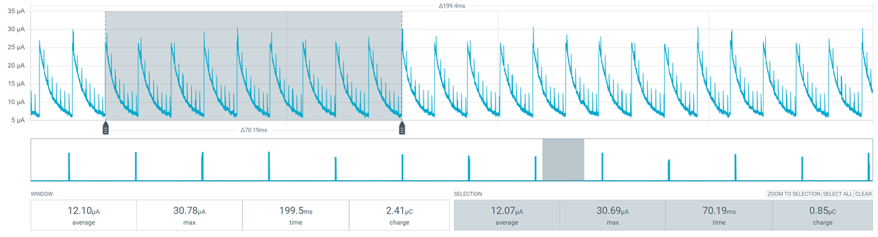

I want to try to lower the idle current as much as possible. When I zoom into the idle region, I see this:
There seem to be periodic spikes every ~8 ms which decay. I know that the BMA400 consumes around ~4 uA when active.
Does anyone know what the source of these spikes are?
