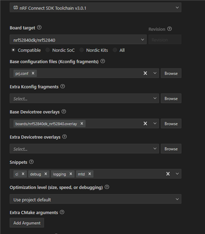

    How do I get debug log output from ot:coap?  I've included the 'debug' snippet, and the 'logging' snippet, but am not seeing an low level debug output.
    How did you include snippets?
    For logging, you can look at OpenThread logging levels and Zephyr L2 logging options.
    Dejan
  • Yes. Everything worked fine NCS 2.4.1.  The reset problem occurs with NCS 3.0.1.
    I included the snippets in the build configuration. (mtd, debugging, logging, ci).  Using the same snippets, I get a ton of debug log messages when I compile with NCS 2.4.1, but only application level logs with NCS 3.0.1.
