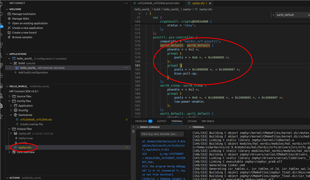

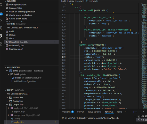

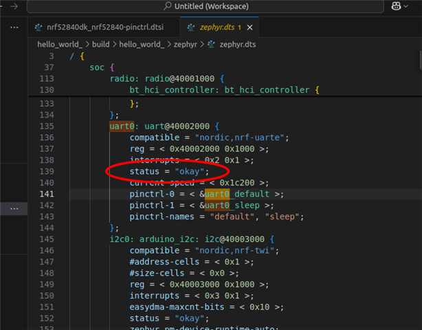

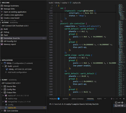

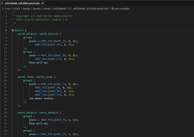

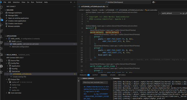

Hello, I've completed nRF Connect SDK Fundamentals Certificate of Completion but I've noticed a little problem with printk and logging.
When I use build configuration with board nrf52840dk/nrf52811 the output show the results I expected, when I use nrf52840dk/nrf52840 the output is not produced.
The problem is produced from blinky to all the excercises further.
With RTT the output is shown correctly.
DevBoard nrf52840dk with MCU PCA10056 2.0.1 2020.53 683522331, ncs v.2.9.1, west v. 1.2.0, toolchain 2.9.1
The major issue became with bluetooth course because nrf52811 generate overflow with RAM.
Any suggestion on how to procede?
