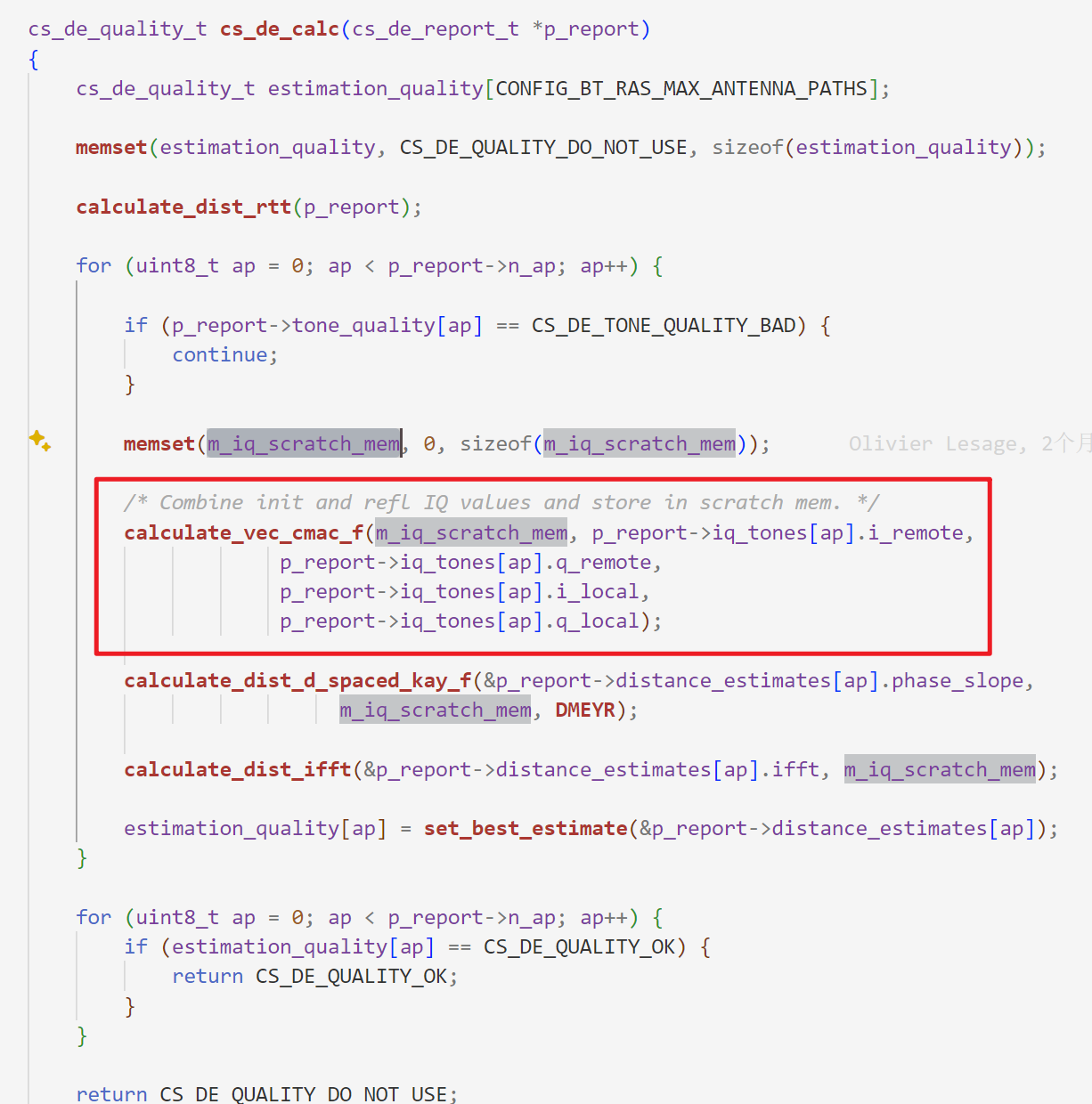

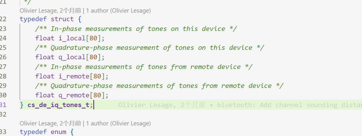

    I apologize for mixing up AoA and Channel Sounding (CS) in my previous question. What I actually want to understand is why, in CS, each subevent only reports a single IQ value per channel.
    From what I know about AoA, it requires a series of phase samples over the CTE part of the packet to estimate the frequency of the whole signal, and then continues sampling on different antennas.
    However, in CS, I noticed that for each enabled channel, only one local IQ and one remote IQ are reported. It seems to me that if there is only a single measurement, the sampling time for local and remote would need to be strictly synchronized (starting from the very beginning of the signal). I’m not sure if my understanding is correct.
    For example, in the cs_de_iq_tones_t structure, the lengths of i_local, q_local, i_remote, and q_remote are all 80, which I assume corresponds to the number of channels—meaning there is only one measurement result per channel. I would like to know why there is only one local IQ and one remote IQ per channel. My intuition is that in order to obtain the phase of the received signal, it would require continuous sampling at multiple points.

  • I don't know the inner details on how this is implemented. But the idea is that they have some sense of a synchronized time. They don't know eachother's time, but there is a set time delay between receiving one packet before the reflector replies, so the time this takes is known.
    The distance is estimated using the phases. If you only did one channel (one frequency), you could see the phase of this signal. In an ideal world, where this is very accurate, you can use this to calculate that you are (N + phase) wawelengths away from the other device. But N is still unknown. So therefore, you do this sweep accross all channels, with different frequencies, and different wavelengths. I am not sure whether they only do one sample per channel, or multiple. When this sweep is done, the estimated distance is calculated based on the phase on all the channels, using different frequencies, and the added phase for each channel, which gives out a resulting distance.
    Of course, in a world that is not ideal, you will have some noise in your measurements, so the result is not 100% accurate. But the sample will also contain a rating saying whether this sample is good or not. You can see this is being checked in ranging_data_get_complete_cb() in the sample.
    If the
    cs_de_quality_t quality = cs_de_calc(&cs_de_report);
    is
    CS_DE_QUALITY_OK
    it gives a quality stamp for that sample, but if it is not, then you can discard the sample.
    Edvin
  • Thank you very much,Edvin,
    What I can confirm is that each channel indeed reports only one sample, as I noticed that in cs_de_report_t, the iq_tones field in cs_de_iq_tones_t is related to the number of antennas. That is, each antenna has up to 80 IQ data points. I believe most of the work has already been implemented in the SDK, and we only need to use a single IQ value to represent the received phase of a given signal.
