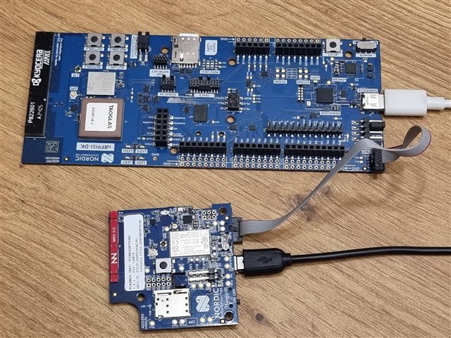

Our company is in the process of developing a new IoT product for LTE-M and NB-IoT. The sample application lwm2m_client runs fine on our devkits nRF9151DK & Thingy91 and connects fine with Leshan, AVSystems and nRFCloud. UART console of both devkits show a lot of shell outputs. So far so good.
Past days I had to debug an issue but depending on some conditions I didn't know some times I could easily SWD debug and sometimes not. In the end I found this out:

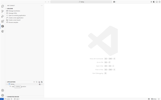

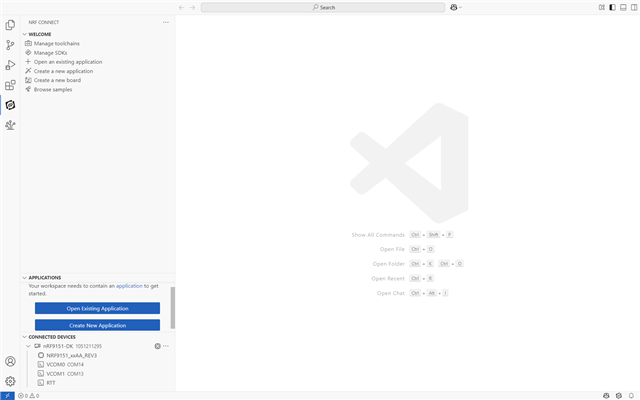

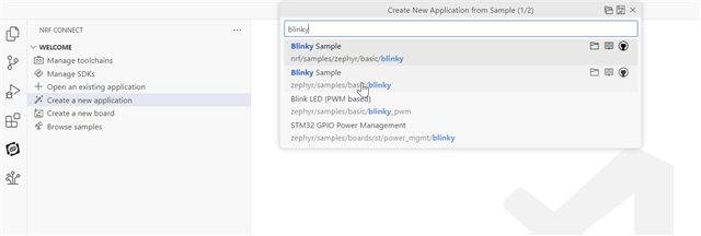

  • Ok, lets first show the good version using the nRF9151DK:

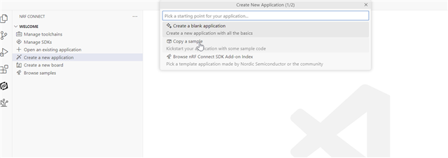

    New VSCode Window:
    create new app, copy sample from "nrf/samples.../blinky"

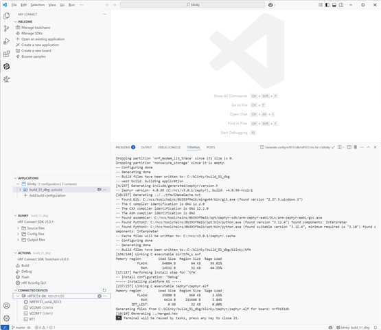

    created in c:\blinky

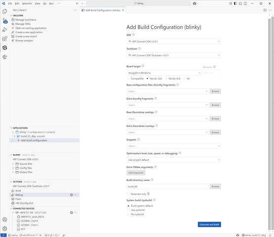

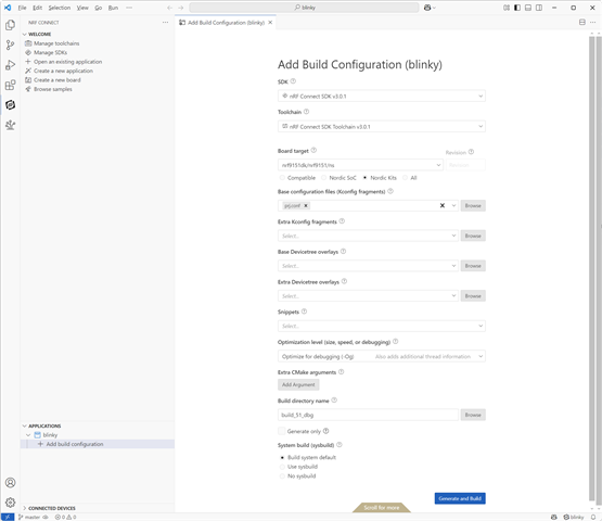

    nrf connect/application/blinky/add build configuration:
    - sdk & toolchain v3.0.1
    - board: nrF9151dk/nRF9151/ns
    - prj.conf
    - optimize for debugging (-Og)
    - Build directory name: build_51_dbg
    - click: generate and build, wait several minutes on my 16 Core i7-1360p
    - build OK:

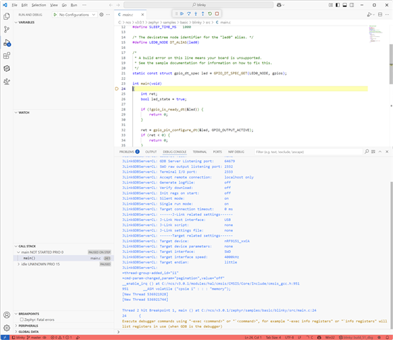

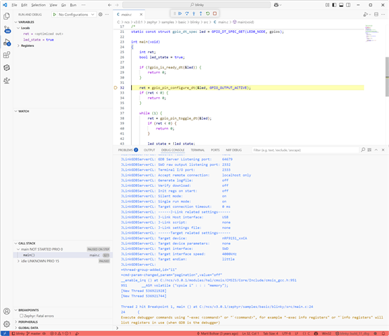

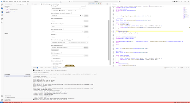

    Click on actions/debug
    - some west magic, flashing, debugg view loads

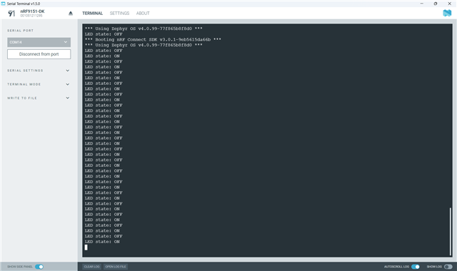

    I can single step using F10:
    Serial terminal is showing blinky Uart output:
    LED1 is blinking

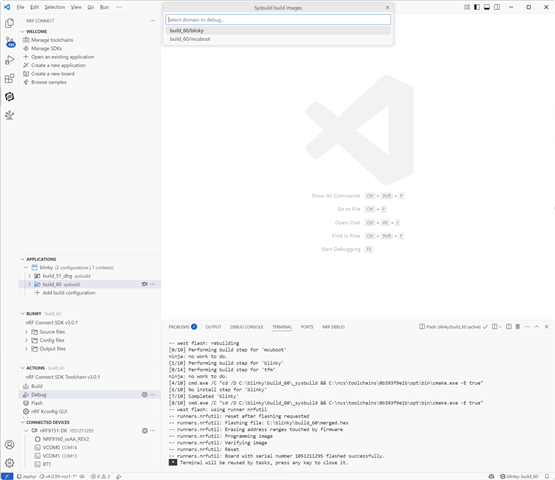

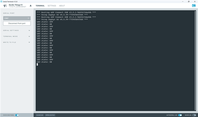

  • Now the good version using Thingy91.

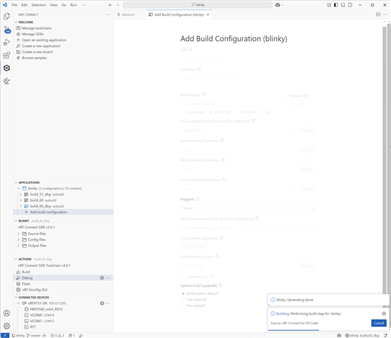

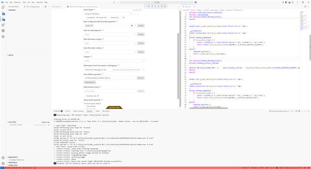

    Lets create a non debug in build_60:
    flash it:
    It blinks and UART output is working:

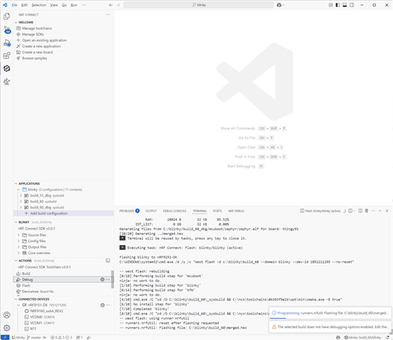

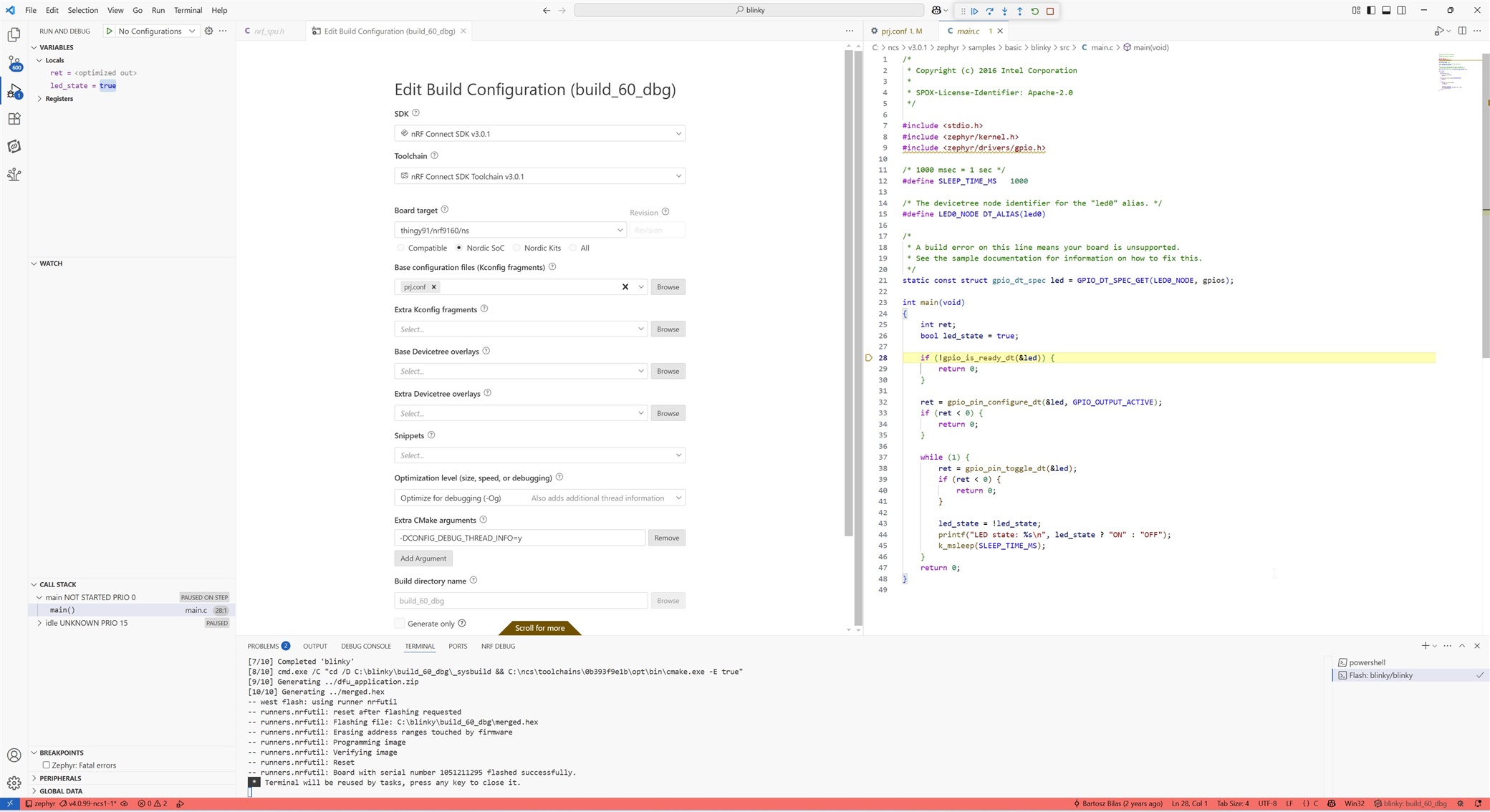

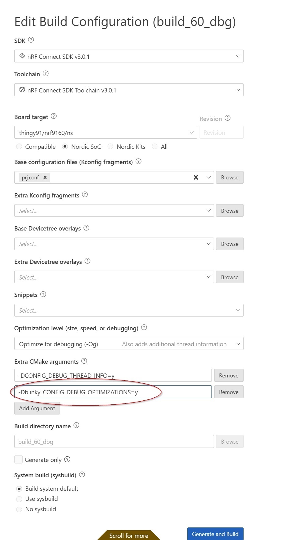

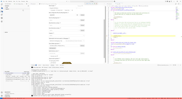

  • Now lets create and build a thingy91 debug version:
    And  lunch the debugger:

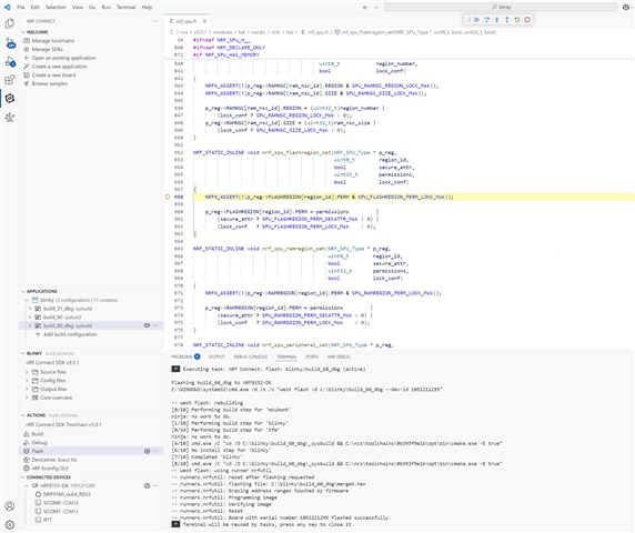

    Now the CPU doesnt hit the apps main():
    single stepping is not working:

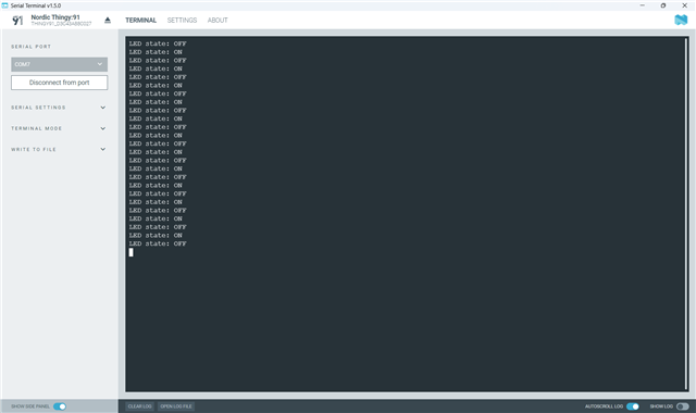

    Oh wow, after several atempts to F10/F5 this time I get a blinking board and a UART output:
    - but the call stack is not showing app threads and I cannot single step

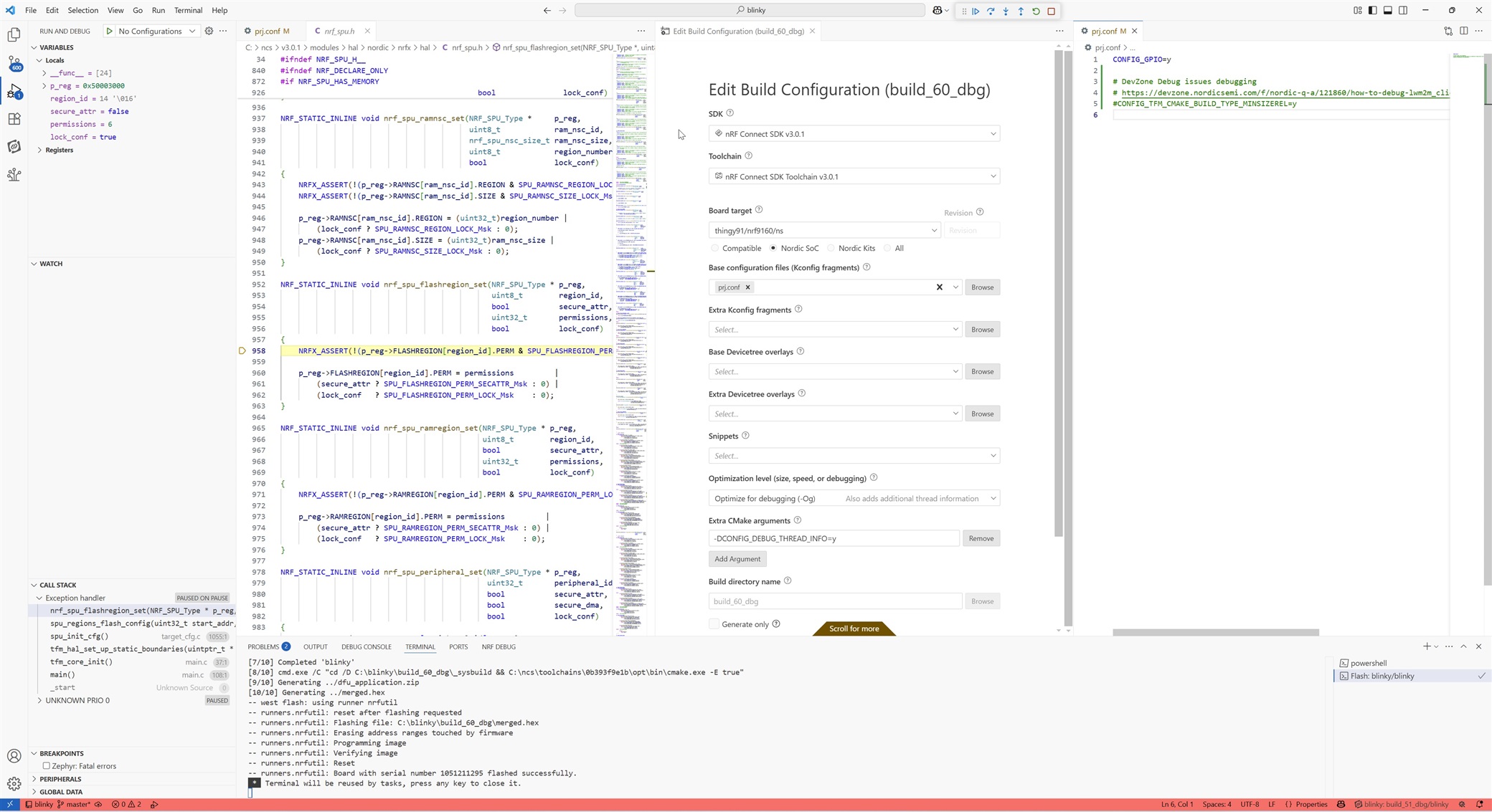

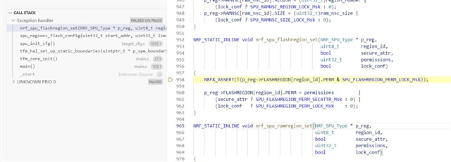

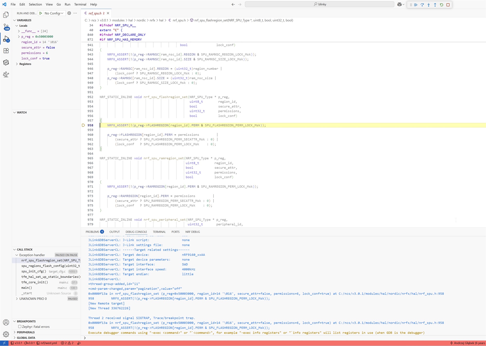

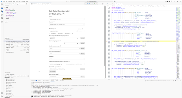

    After stopping the debugger, reflashing, attach debugger it looks like this - that the exception/assertion I see most often when I try to debug the lwm2m_client sample on the thingy91:
    And what helps reliably is to disable "optimize for debug (-Og), use -Os and manually add cmake argument -DCONFIG_DEBUG_THREAD_INFO=y
  • when I try to debug the sample lwm2m_client, it works as expected on the nRF9151DK and not on the thing91, mostly the CPU spins endless in the "flash is not locked" assertion like here:
    So it looks like the larger the app the higher the chance the debug setup is breaking
