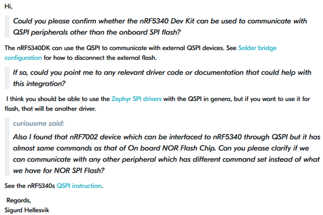

    Could you please confirm whether the nRF5340 Dev Kit can be used to communicate with QSPI peripherals other than the onboard SPI flash?
    The nRF5340DK can use the QSPI to communicate with external QSPI devices. See Solder bridge configuration for how to disconnect the external flash.
    If so, could you point me to any relevant driver code or documentation that could help with this integration?
     I think you should be able to use the Zephyr SPI drivers with the QSPI in genera, but if you want to use it for flash, that will be another driver.
    curiousme said:
    Also I found that nRF7002 device which can be interfaced to nRF5340 through QSPI but it has almost same commands as that of On board NOR Flash Chip. Can you please clarify if we can communicate with any other peripheral which has different command set instead of what we have for NOR SPI Flash?
    See the nRF5340s QSPI instruction.
