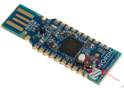

Bricked nrf52840 Dongle
I thought I had been extremely careful to _not_ brick the device, but apparently I did.

I saw output saying "device programmed" with  a progress bar before it that went to 100%, suggesting that at least *something* was flashed. Before (from the distributor) the device was in DFU mode, showing a dimming orange LED and it would show up in both dmesg and lsusb (as checked by the code), but afterwards it just seems dead/bricked.

  1. How do I recover to factory settings (assuming I have little to no tools right now, but I can buy tools)? I pressed the white button (there are no other buttons visible) in an attempt to reset to factory settings.

    You got two options:
    Reprogramming the Dongle using a debugger. This is the "nuclear option", which requires you to connect the Dongle to the DK.
    However, I think you missed a button, so you should still be able to put the Dongle into DFU mode and then program it again.
    In addition from the button you see, there is a sideways button:
    Press this (from the arrow direction) when the Dongle is plugged in. The Dongle should now enter programming(DFU) mode, and the LED should tart blinking(fading) red.
    Overall, I consider it a _horrible_ developer experience for trying to do something which should have been simple (adding an OBTR to the network).
    If you want a more graphical method for programming the Dongle, try to download nRF Connect for Desktop, open the Programmer app, select the hex and then press "program" when the dongle is in programming mode.

  • It started dimming again and listed under lsusb again. So, hardware saved and thank you for that. 100
