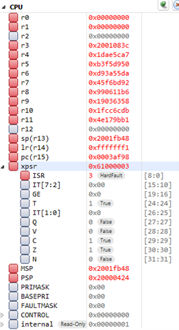

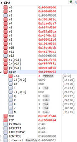

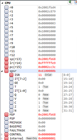

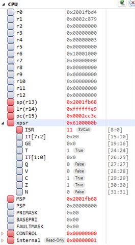

    In debug mode, when I go into APP_ERROR_CHECK(nrf_sdh_enable_request(), the debug jump to SVCALL(SD_SOFTDEVICE_ENABLE, uint32_t, sd_softdevice_enable(nrf_clock_lf_cfg_t const * p_clock_lf_cfg, and right after click "Step Into", the debug stop at void vPortSVCHandler( void ) and the register values are like there:
    Go forward  1 step and the debug goes to hardfault handler, and  the register values are there:
