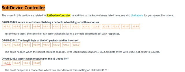

I am getting an occasional softdevice assert on a BLE central device (hub).  Both the central and peripheral devices are nRF52840 using Coded PHY and NCS v2.7.0.  This error will not happen until after a peripheral is connected but it can happen any time after that even if the device disconnects.
The fault is below:

I have these options enabled:
CONFIG_BT_HCI_TX_STACK_SIZE=4096
CONFIG_DEBUG_THREAD_INFO=y
CONFIG_DEBUG_COREDUMP=y
The coredump file is attached.
