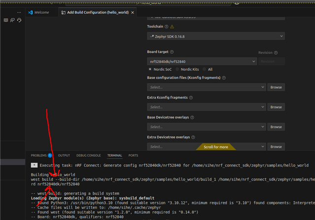

  • CurtisHx2 said:
    At the very high level, I think I need a command line equivalent of the "Add Build Configuration" wizard in the nRF Connect VSCode plugin.  The reason for that is most (all?) of my team is going to be using the nRF Connect plugin for development work, and I want the CI/CD environment to be consistent with the developer environment  I looked around to see if something like that exists and I couldn't find anything.
    The VS Code extension just uses "west" under the hood, so you can use "west" command all the same.
    Here you can see the exact command that VS COde uses when you click build:
