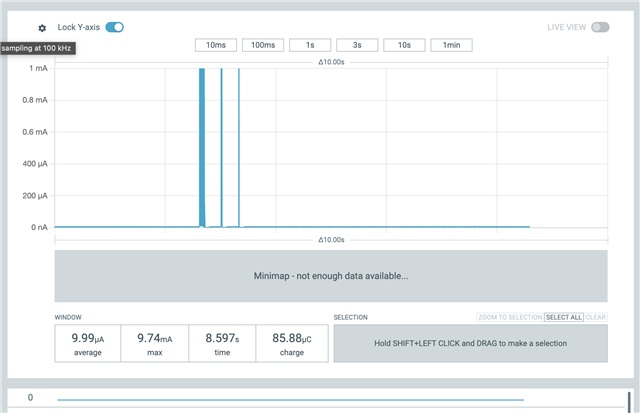

2. After an NFC tap, the current will spike and then return to this low power state of ~10 uA. (see nfc_tap_good.png)

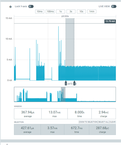

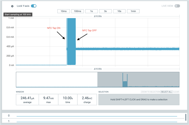

3. Sometimes, after the NFC tap, the device does not return to the low power state and will sit in the high current state of ~200+ uA. This high current state does not go away. (See nfc_tap_high_current.png)
4. If I tap the device again, I do sometimes see the power drop back down to 10 uA after the NFC_T2T_EVENT_FIELD_OFF event but other times it does not.
In my testing, usually with an iPhone tap, this high power state would not occur, but I could reproduce it occasionally. However with a USB NFC reader (ACR122U), this seemed to happen much more frequently (around 75%) of the time.
