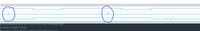

UART API not catching RX data
I am having some trouble with the UART API (Async and interrupt). I am connecting the development board (nrf9151 DK) to a 3rd party device (keypad / prox reader) and I cannot seem to "catch" the inbound data. To give a little more context on the sequence of events..
The reader initiates the communication with the development kit through an interrupt line.
The development kit then sends a data packet to the reader (less than 48 bytes)
The reader then responds with the relevant data (less than 48 bytes).
Communication is over. to send more data you must repeat the process.
I have tried this with two different readers, along with a development board and a custom board that I am making. All result in the same issue UART_RX_RDY is never triggered. If it is, only 1 byte comes through. All of this is happening over UART 2. This is leading me to think I my set up is incorrect. I have looked at both the lpuart example and the dev academy lesson as well as set the pins on the DK to both 1.8 v and 3.3 v.
Information about the reader:
There is no CTS or RTS line, only RX and TX.
Baud is 9600
Uses OSDP for communication protocol.
Quick note about the OSDP communication - The data for the tx line is formatted correctly (I've had this working in the past but needed to rework a few parts of the application). A valid response should return 43 bytes starting with a 0x53 and invalid should return with about 12 bytes starting with a 0x53 as well.
Any guidance or suggestions would be appreciated.

  • Hi Hakon,
    I have run the logic analyzer (attached the photo below).
    Line 0 is TX / Line 1 is RX / Line 2 is the initiation pin.
    If I change the timeout setting in the RX enable call, it still does not extend the window for RX data.. the logic pins look the same. My suspicion is that the external device does not have time to receive the data and send a response.
    Do you have any suggestions on extending the RX timeout, given the  uart_rx_enable call is not extending it.
    Thanks
    Jack
  • Did you change the order of the pins shown in the logic trace image? I don't understand what you are measuring. Why is there activity on TX at the same time as RX pin? Are you sending and receiving data at the same time?
  • The line at the top is the TX data, the line in the middle is the interrupt pin (which is the trigger for this sequence), the bottom line is the RX data.
    The goal is very basic - I have data i need to send to a peripheral device. The interrupt pin starts the communication, TX data is sent from the dev kit, then RX data should be received from the peripheral device.. Sequence complete
    In the image below, I am trying to measure if data is coming back on the RX line, which it is (right side of the image). I do not get data back on the first interrupt trigger, only the second. The RX pin is being held high for too long and i don't know how to change that. The gap between the two points on the middle line is about 0.5 seconds.
    The RX line has this pattern for Polling, ASYNC, and Interrupt. I am assuming I am either using the wrong driver or have configured things wrong in the device tree.
    Thank you,
    Jack

  • I took out the the fields you mentioned and am still seeing the same pattern. This image below is zoomed in on the left side of the total event.
    I wanted to update this ticket... data is now coming back over the RX line but there is still the issue with RX line being held high for too long. Do you have any suggestion on how to change that?
    In the image below, I trigged the interrupt twice. The first time data does not come back. The second time it does. As you can see the RX line is held high for a set duration. I am trying to change that.
    Top line: TX
    Mid line: Interrupt pin
    Bottom line: RX
    As for data coming back, The DT config I left out is below. Once I added this back in, the ASYNC API received data (on the second interrupt event)
