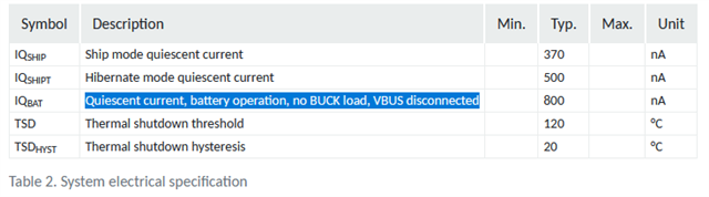

Hi lewisleman,
The quiescent current for Ship and Discharge mode are provided in section 3.7, Electrical characteristics, of the product specification. Typical value is also noted in the next section, System electrical specifications.
There doesn't seem to be an output current vs dropout chart yet, unfortunately.

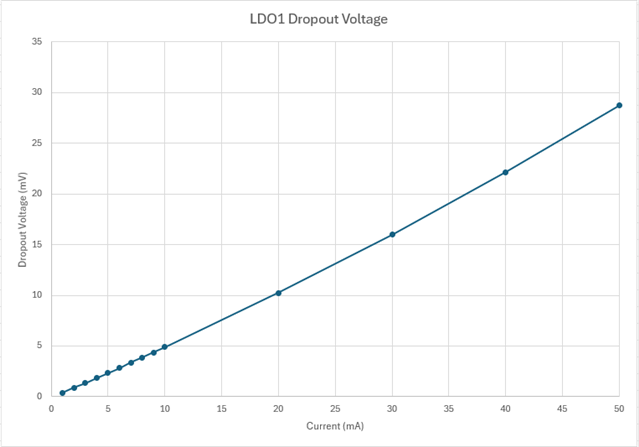

The description doesn't mention LDO operation. I assumed the LDO is disabled for this condition. Can you confirm if the test condition for the 800nA spec includes LDO turned on?
My apology. LDO quiescent current is 4.5uA from the VSYS rail and 8uA from the LSINx.
This is the dropout vs output current chart:
This is perfect. Thank you
