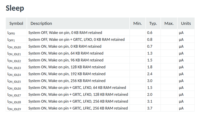

About nRF54L idle current

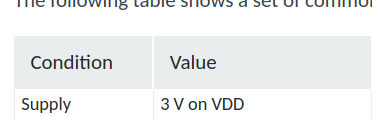

Is there any sample code that can check the Ion_idle8 current below?
I am currently evaluating the following currents on a custom boat and it is running at around 4uA.
The sample code being checked is as follows:
・peripheral_bms
The prj.conf settings are attached.
prj_test.conf
add overlayfile
xtal_reg_dcdc.overlay
