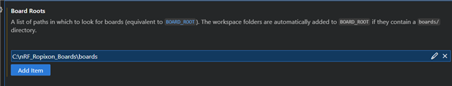

I saved my board in C:\nRF_Ropixon_Boards\boards.

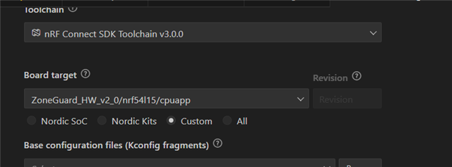

I added path to my custom board - hope correctly:
I set board like that:

    Try removing "\boards" from the Board root settings in the nRF Connect for VS Code extension.
    As long as the build log says:
    BOARD_ROOT element without a 'boards' subdirectory:
    it means that it is incorrectly included. But you can also see that the build log says:
    - if your board directory is '/foo/bar/boards/my_board' then add '/foo/bar' to BOARD_ROOT, not the entire board directory
    So the "/boards" should never be included in the board root.
    Edvin

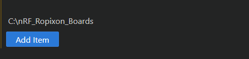

    I have tried it, but it did not help: Error is stil the same and CMakeCache.txt also..
    There is a board and project if it can help?
    nRF_Ropixon_Boards.zip1261.project.zip

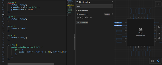

  • I tried one thing – I created a new board using the VSCode nRF plugin, then added it to the hello world project and compiled successfully. But then I opened the .dts file and, using the graphical editor, I added pins for UART TX and RX. I saved the .dts and tried to compile the project again – and I got exactly that error. Why did this happen?
    So after your board root was just:
    C:\nRF_Ropixon_Boards, and you tried to build, what was the build log?
    What error? Please share build logs.
    Edvin
    I can see it, it is problem with my overlay now. Is there any tutorial with nRF connect v3.0? I want to make cusotm board for nRF54l15 --  still do not understand correctly how it works.
