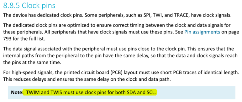

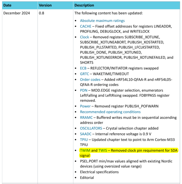

Hi Nordic teams :
I find that datasheet v0.8 (page12) shows that SDA do not need clock.
Page 277 still shows that SDA need clock pin.
Could you help to clarify which information is correct?

Hello Webster,
May I know if you are refering to nRF54L15?
There's a new updated nRF54L15 datasheet v0.9 available in here:
https://docs.nordicsemi.com/bundle/ps_nrf54L15/page/keyfeatures_html5.html
Wish this provides some help.
