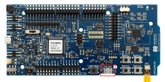

    Which version of the nRF Connect SDK are you using?
    Your example works when I test it on the nRF52840 DK with v3.0.0.
    Please note that by default, the USB CDC ACM on the DK is the nRF USB, and not the UART routed through the interface MCU, so you must connect the USB cable to the nRF USB connector:
    Here is everything you need to add for USB CDC ACM in a project:
