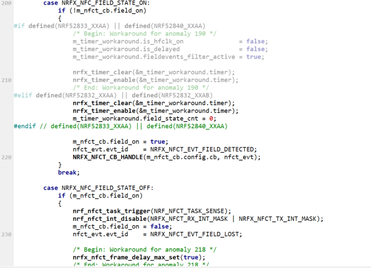

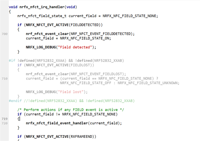

    As shown in this picture of our board, the SDK is not configured to send the "Field Off" interrupt—only the "Field On" is enabled.
    In this picture, the handler safeguards against the case where a "Field On" event can occur without a corresponding "Field Off" event, using the m_nfct_cb.field_on flag.
    However, the "Field Off" event is never triggered or handled in this function.

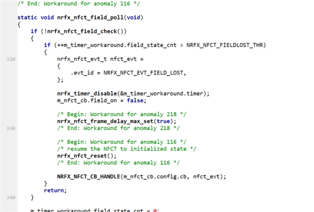

    Instead of being called from the callback, we call it from the function below and reset m_nfct_cb.field_on.
    However, unlike the callback, we don’t check whether this value has already been reset.
    I prefer not to modify the SDK files, but something doesn't seem to be working correctly.
    After debugging, I noticed that sometimes the device receives two interrupts from nrfx_nfct_field_poll(), which causes it to get stuck. Occasionally, the device also hangs during the execution of this function—specifically before the call to nrfx_nfct_frame_delay_max_set(true);.
