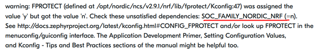

warning: FPROTECT (defined at /opt/nordic/ncs/v2.9.1/nrf/lib/fprotect/Kconfig:47) was assigned the
value 'y' but got the value 'n'. Check these unsatisfied dependencies: SOC_FAMILY_NORDIC_NRF (=n).
See docs.zephyrproject.org/.../kconfig.html and/or look up FPROTECT in the
menuconfig/guiconfig interface. The Application Development Primer, Setting Configuration Values,
and Kconfig - Tips and Best Practices sections of the manual might be helpful too.
