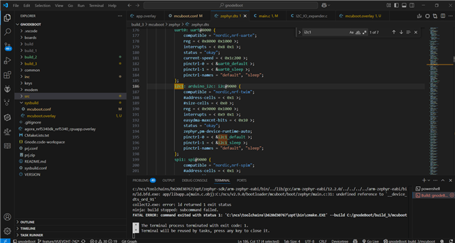

and define i2c_dev in main.c as
const struct device *i2c_dev = DEVICE_DT_GET(DT_NODELABEL(i2c1));
but I am getting error
C:/ncs/v2.9.0/bootloader/mcuboot/boot/zephyr/main.c:31: undefined reference to `__device_dts_ord_105'
how to resolve this
    The error 'undefined reference to '__device_dts_ord_105' shows that either I2C is not enabled in the final devicetree for MCUboot or the required I2C driver is not enabled in the MCUboot build. Can you please check here in the zephyr.dts file (build/mcuboot/zephyr/zephyr.dts) is the i2c1 has 'status = "okay" '?
    If not, the overlay may not be applied correctly. Make sure the overlay file is in the correct location and named properly.

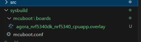

    • For nRF5340 custom board, use child_image/mcuboot/boards/<your_board>.overlay (multi-image), for generic child_image/mcuboot.overlay or sysbuild/mcuboot/boards/<your_board>.overlay (Sysbuild), for generic sysbuild/mcuboot.overlay

    I tried it with
    and tried to build the project I got error
    CMake Error at C:/ncs/v2.9.0/zephyr/cmake/modules/extensions.cmake:2923 (message):
      No prj.conf file(s) was found in the C:/gnodeBoot/sysbuild/mcuboot
      folder(s), please read the Zephyr documentation on application development.
