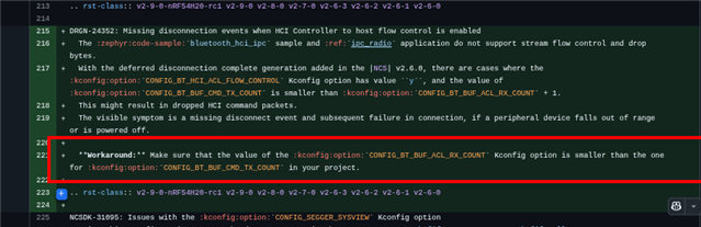

  • Hello Prashant,
    Sorry it didn’t work. Did you make sure to set CONFIG_BT_BUF_CMD_TX_COUNT to a larger value than CONFIG_BT_BUF_ACL_RX_COUNT in the ipc_radio project? I realize that this requirement (i.e. CONFIG_BT_BUF_CMD_TX_COUNT >= CONFIG_BT_BUF_ACL_RX_COUNT + 1) was not made very clear in my previous response. Here is from the known issue descritption:
    (commit: https://github.com/nrfconnect/sdk-nrf/pull/19869/commits/6c02a2b307297638bb92c18ccea514ea4326e71b)
    Vidar
  • Update: in addition to what I suggested above, it may be necessary to increase the CONFIG_BT_CTLR_SDC_TX_PACKET_COUNT setting in the IPC radio firmware to match this equation:
    (max_conn - 1) * MaxAttPacket + 1
    , where MaxAttPacket is the maximum number of ATT packets your application will queue per connection.
    The application must also ensure it does not queue more than "MaxAttPacket" per connection, especially when link quality drops in cases were a device is moving out of range. If the application is using GATT APIs with callbacks like bt_gatt_notify_cb, it can use the callbacks to monitor how many ATT packets are queued for each link.
    For example, let's say your application needs to support 3 peripheral or central role connections, and each link should be allowed to queue up to 3 ATT packets:
    (3 -1) * 3 +1 =7
    So in this case, CONFIG_BT_CTLR_SDC_TX_PACKET_COUNT should be set to 7. In the application, you must also ensure that no more than 3 write or notify packets are queued for a given connection at any time.
