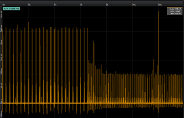

In setup 1; SW6 is set to nRF ONLY, SW10 is OFF, SW9 is VDD.
I get the below current draw for this setup, where the first part of the trace is for BLE Advertising, and second (more attenuated) part is for when BLE is connected. Average current draw during advertising is 138uA, and during connected state it is 86uA.

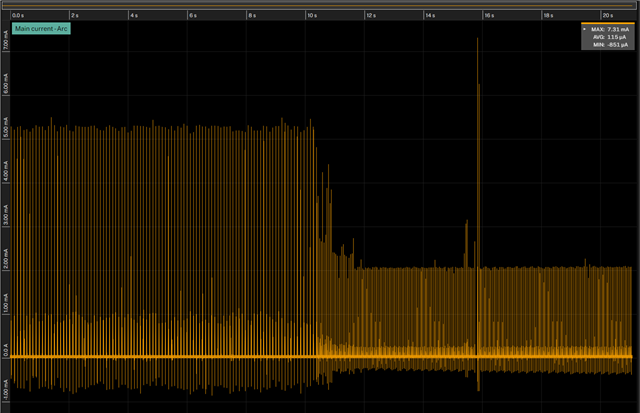

In setup 2; SW6 is set to nRF ONLY, SW10 is ON, SW9 is VDD, and a USB cable is connected to J2 which is connected to a PC on the other end.
In this setup, I get 132uA average during advertising mode, and 82uA during connected state.
The current draw measurements seemed quite low to me, but I can connect to the device successfully over BLE using the nRF Connect for Mobile app and read/write characteristics.
