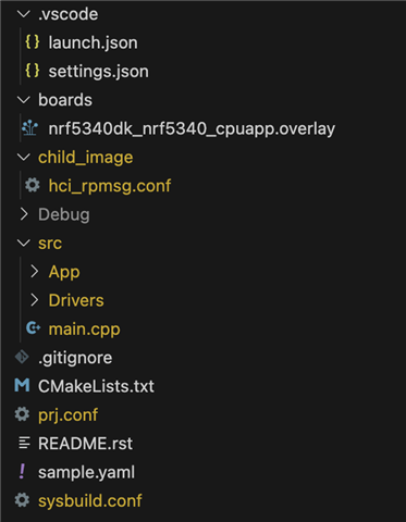

Below is the structure of my project:
Can anyone help me?

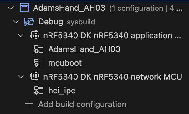

UPDATE: I tried following this tutorial: https://academy.nordicsemi.com/courses/nrf-connect-sdk-intermediate/lessons/lesson-9-bootloaders-and-dfu-fota/topic/exercise-5-fota-over-bluetooth-low-energy/
I added the line SB_CONFIG_BOOTLOADER_MCUBOOT=y to my sysbuild.conf file:
SB_CONFIG_NETCORE_APP_UPDATE=y
SB_CONFIG_NETCORE_HCI_IPC=y
I removed the line CONFIG_BOOTLOADER_MCUBOOT=y from my prj.conf file and kept the line CONFIG_NCS_SAMPLE_MCUMGR_BT_OTA_DFU=y. The project compiles without errors, but the firmware no longer works. If I start debugging, the code "gets lost" somewhere, and I don't understand why.
