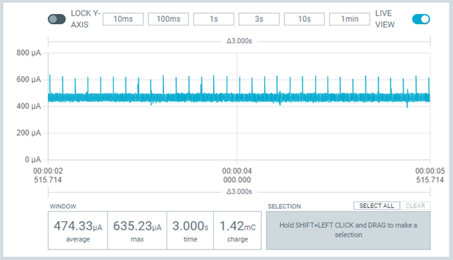

I analyzed every step of sensor configuration to see where the current consumption increase occurs. It turns out that this happens here:
MOTION_InitSensor() -> sensor_trigger_set()
Jumping to ...ncs//v3.0.1/zephyr/drivers/sensor/st/lis2dh/lis2dh_trigger.c:
lis2dh_trigger_set() -> lis2dh_trigger_anym_set() -> lis2dh_trigger_anym_tap_set()
In the last function, the last thing it does is:
k_work_submit(&lis2dh->work);
Commenting out just this line makes the average consumption decrease back to normal, which is < 10uA. but then, of course, we have no trigger. Uncommenting it causes a big static consumption increase - see the figure below:
I checked that the trigger handler is called as expected, i.e. only when acceleration is present, no spurious interrupts occur. There is no I2C traffic when the sensor is at rest, as expected.
One solution would be to drop the Zephyr sensor driver and tweak the accelerometer registers & configure the interrupt GPIO input manually, but this is against the elegance that Zephyr brings. So my question: what causes this current consumption and how to avoid it?
