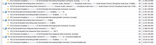

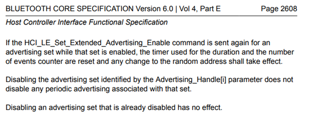

Enabling an advertising set already enabled trigger the HCI error command disallowed
When Enabling an advertising set already enabled on the Softdevice Controller, the HCI error command disallowed is produced when according to the BLE specification 6.0 it should be possible without any error.
Vol4 Part E Chapter 7.8.56

nordic_advertising_enable_issue.btt
    You can find here a project with the minimum of dependencies possible exposing the issue of the ticket: Cyrillius/NordicTestBench: A simple project in order to test the Softdevice Controller from Nordic in standalone
    The output of the test should look like this:

    2025-06-19 08:18:26,355 - twister - DEBUG - DEVICE: [00:00:01.276,763] <dbg> sdc_testbench: sdc_testbench_test_enabling_advertising_twice: enable advertising second time
    2025-06-19 08:18:26,364 - twister - DEBUG - DEVICE: [00:00:01.276,794] <dbg> sdc_testbench: bt_hci_cmd_create: opcode 0x2039 param_len 6
    2025-06-19 08:18:26,372 - twister - DEBUG - DEVICE: [00:00:01.276,824] <dbg> sdc_testbench: bt_hci_cmd_create: buf 0x20006a68
    2025-06-19 08:18:26,379 - twister - DEBUG - DEVICE: [00:00:01.276,855] <dbg> bt_hci_driver: bt_ipc_send: buf 0x20006a68 type 0 len 9
    2025-06-19 08:18:26,387 - twister - DEBUG - DEVICE: [00:00:01.276,885] <dbg> bt_hci_driver: bt_ipc_send: Final HCI buffer:
    2025-06-19 08:18:26,397 - twister - DEBUG - DEVICE: 01 39 20 06 01 01 01 f4  01 00                   |.9 ..... ..
    2025-06-19 08:18:26,403 - twister - DEBUG - DEVICE: [00:00:01.277,374] <dbg> bt_hci_driver: bt_ipc_rx: ipc data:
    2025-06-19 08:18:26,413 - twister - DEBUG - DEVICE: 04 0e 04 01 39 20 0c                             |....9 .
    2025-06-19 08:18:26,420 - twister - DEBUG - DEVICE: [00:00:01.277,404] <dbg> bt_hci_driver: bt_ipc_evt_recv: len 4
    2025-06-19 08:18:26,428 - twister - DEBUG - DEVICE: [00:00:01.277,435] <dbg> bt_hci_driver: bt_ipc_rx: Calling bt_recv(0x20008298)
    2025-06-19 08:18:26,438 - twister - DEBUG - DEVICE: Assertion failed at CMAKE_SOURCE_DIR/src/main.c:59: expect_receive: exp_data not equal to rx_msg->data
    2025-06-19 08:18:26,445 - twister - DEBUG - DEVICE: [00:00:01.277,587] <dbg> bt_hci_driver: bt_ipc_rx: RX buf payload:
    2025-06-19 08:18:26,456 - twister - DEBUG - DEVICE: 0e 04 01 39 20 0c                                |...9 .
    2025-06-19 08:18:26,461 - twister - DEBUG - DEVICE: FAIL - test_enabling_advertising_twice in 1.004 seconds
    2025-06-19 08:18:26,467 - twister - DEBUG - DEVICE: ===================================================================
    2025-06-19 08:18:26,469 - twister - DEBUG - DEVICE: TESTSUITE sdc_testbench failed.
    2025-06-19 08:18:26,478 - twister - DEBUG - DEVICE: [00:00:01.377,807] <dbg> sdc_testbench: teardown: reset bluetooth controller stack
    2025-06-19 08:18:26,487 - twister - DEBUG - DEVICE: [00:00:01.377,838] <dbg> sdc_testbench: bt_hci_cmd_create: opcode 0x0c03 param_len 0
    2025-06-19 08:18:26,495 - twister - DEBUG - DEVICE: [00:00:01.377,868] <dbg> sdc_testbench: bt_hci_cmd_create: buf 0x20006a68
    2025-06-19 08:18:26,502 - twister - DEBUG - DEVICE: [00:00:01.377,868] <dbg> bt_hci_driver: bt_ipc_send: buf 0x20006a68 type 0 len 3
    2025-06-19 08:18:26,510 - twister - DEBUG - DEVICE: [00:00:01.377,899] <dbg> bt_hci_driver: bt_ipc_send: Final HCI buffer:
    2025-06-19 08:18:26,520 - twister - DEBUG - DEVICE: 01 03 0c 00                                      |....
    2025-06-19 08:18:26,526 - twister - DEBUG - DEVICE: [00:00:01.378,479] <dbg> bt_hci_driver: bt_ipc_rx: ipc data:
    2025-06-19 08:18:26,536 - twister - DEBUG - DEVICE: 04 0e 04 01 03 0c 00                             |.......
    2025-06-19 08:18:26,543 - twister - DEBUG - DEVICE: [00:00:01.378,509] <dbg> bt_hci_driver: bt_ipc_evt_recv: len 4
    2025-06-19 08:18:26,551 - twister - DEBUG - DEVICE: [00:00:01.378,570] <dbg> bt_hci_driver: bt_ipc_rx: Calling bt_recv(0x200082b4)
    2025-06-19 08:18:26,558 - twister - DEBUG - DEVICE: [00:00:01.378,601] <dbg> bt_hci_driver: bt_ipc_rx: RX buf payload:
    2025-06-19 08:18:26,568 - twister - DEBUG - DEVICE: 0e 04 01 03 0c 00                                |......
    2025-06-19 08:18:26,571 - twister - DEBUG - DEVICE: ------ TESTSUITE SUMMARY START ------
    2025-06-19 08:18:27,595 - twister - DEBUG - DEVICE: SUITE FAIL -   0.00% [sdc_testbench]: pass = 0, fail = 1, skip = 0, total = 1 duration = 1.004 seconds
    2025-06-19 08:18:28,614 - twister - DEBUG - DEVICE: - FAIL - [sdc_testbench.test_enabling_advertising_twice] duration = 1.004 seconds
    2025-06-19 08:18:30,650 - twister - DEBUG - DEVICE: ------ TESTSUITE SUMMARY END ------
    2025-06-19 08:18:31,673 - twister - DEBUG - DEVICE: ===================================================================
    2025-06-19 08:18:31,675 - twister - DEBUG - DEVICE: PROJECT EXECUTION FAILED

    You are correct. I discussed this with our softdevice controller team now, and they say that it is indeed not following the specification.
    I have created an internal ticket, where they will look into it, but it does require a patch in the softdevice controller, so a fix will be implemented in a future release, but not the current one.
    In the meantime, as a workaround, you need to disable that specific advertising before you restart it.
    Again, thank you for reporting this bug!
    Edvin
