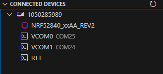

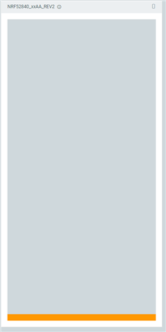

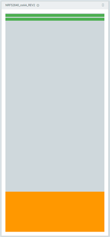

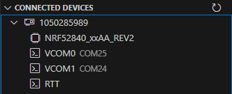

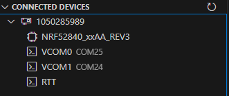

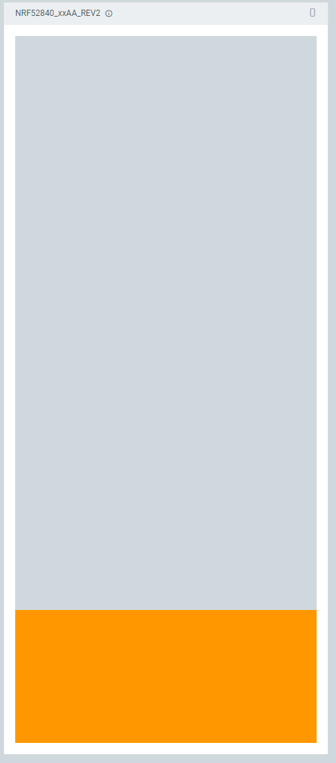

We have designed a custom PCB using the BC840 from Fanstel. We have been able to connect to and program both the BC840 evaluation board (EV-BC840-V0) and the custom PCB using an nRF52840DK; however, we do not observe the associated functionality from our PCB that we see from the evaluation board even for simple programs using just RTT and BLE. We believe the PCB is connecting and programming correctly because it appears and flashes in nRF Connect SDK for VSCode in the same manner as the evaluation board.
Just the DK in nRF Connect SDK for VSCode
Evaluation Board + DK in nRF Connect SDK for VSCode
PCB + DK in nRF Connect SDK for VSCode

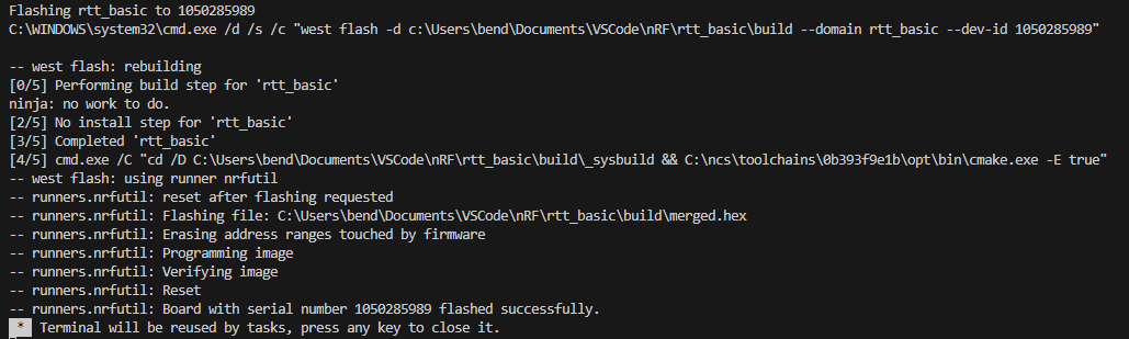

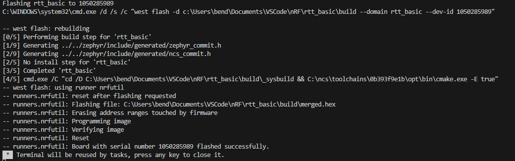

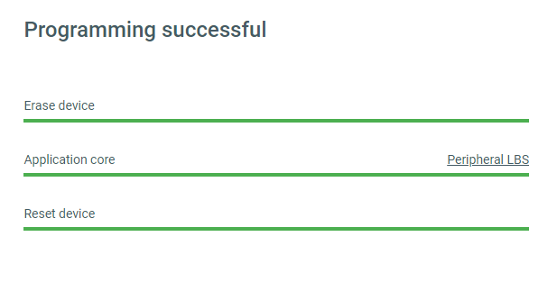

Flashing to Evaluation Board
Flashing to PCB

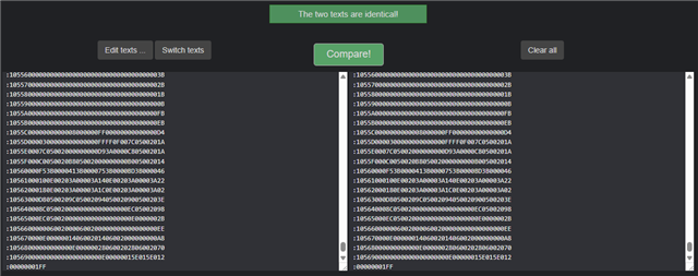

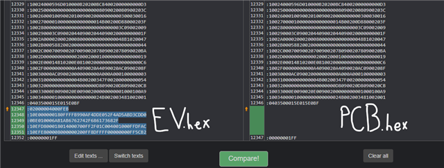

In addition, we confirmed that the PCB is being programmed correctly using the Programmer in the nRF Connect for Desktop application by erasing the boards fully and then comparing the contents of the device memory of the evaluation board and the PCB after flashing the same RTT program to them. They appeared identical.
Evaluation Board
PCB
Comparison of Device Memory .hex Files

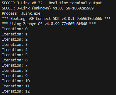

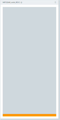

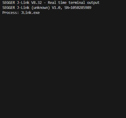

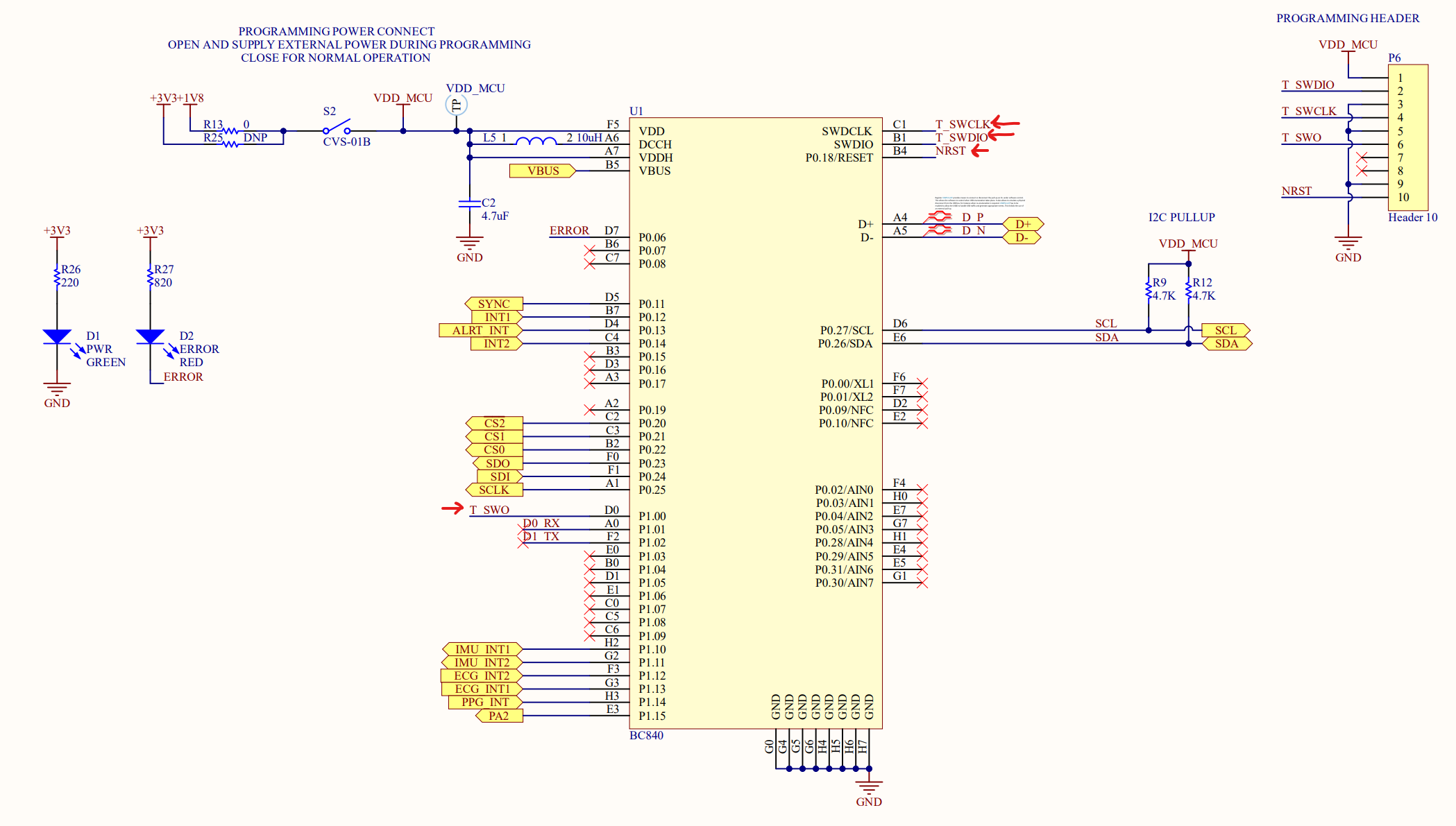

Thus, it appears that we are effectively programming our custom PCB. However, when checking for the output of our program over RTT, only the evaluation board appears to be providing any data.
RTT Output from Evaluation Board
RTT Output from PCB

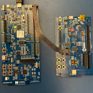

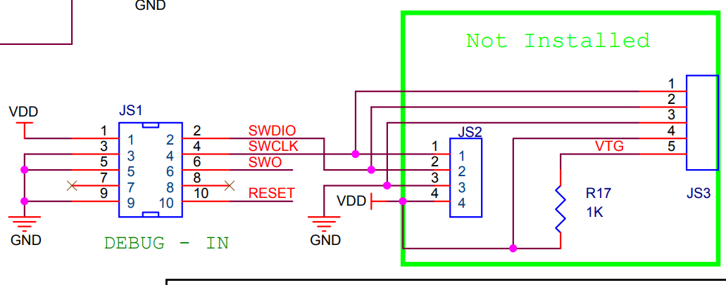

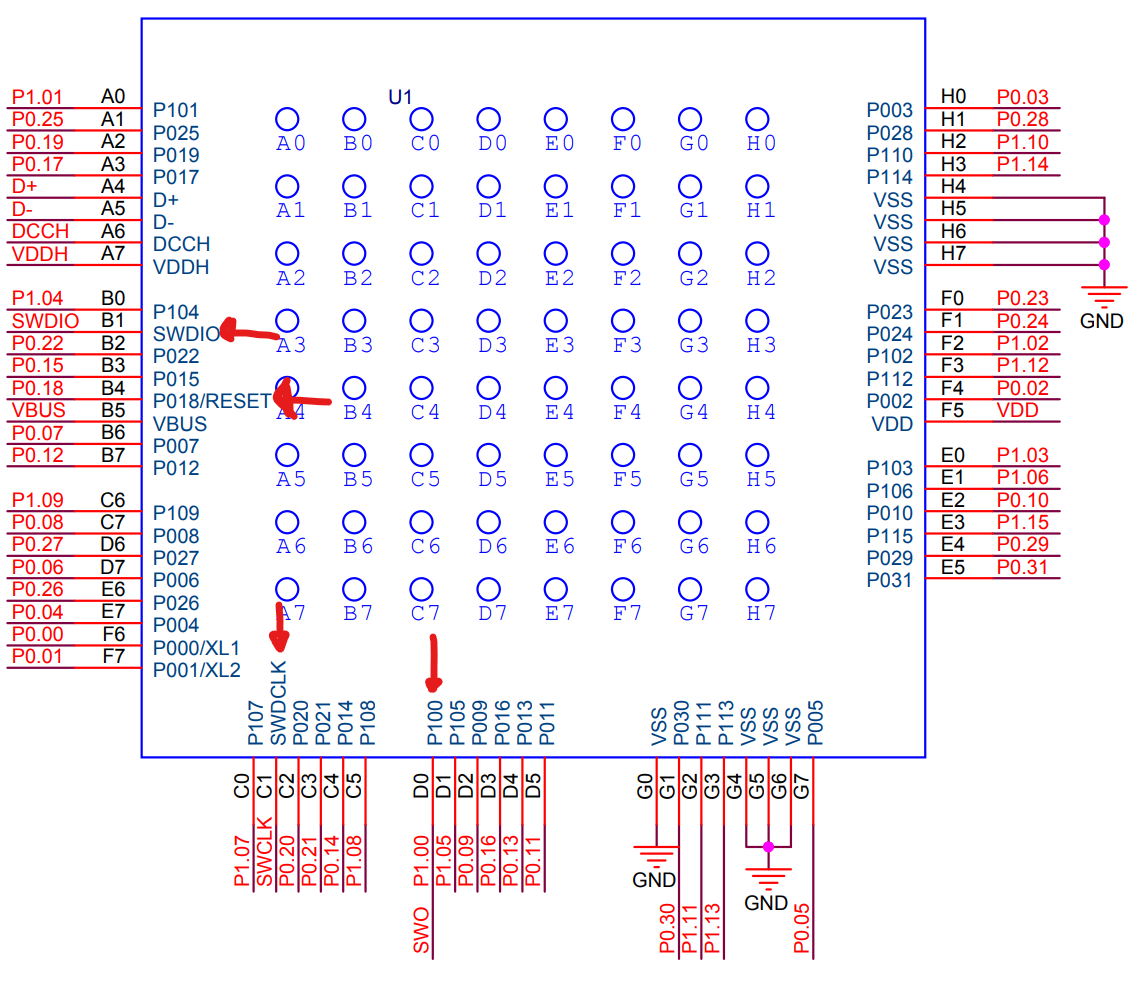

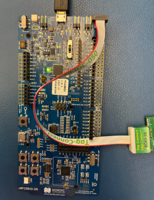

In order to make programming our devices easier, we have connected solder bridge 47 (SB47) to allow us to supply power to the device from the DK board itself. Thus, between the evaluation board/PCB and the DK, the only connection is the 10 pin Tag Connect Cable.
Connection to Evaluation Board
Connection to PCB
The connections should be the same. This leads to our confusion about why are we able to successfully connect and program our PCB, but not able to receive output from it in the same way as our evaluation board?

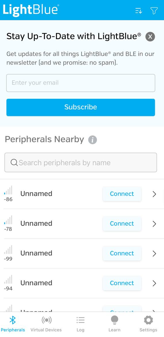

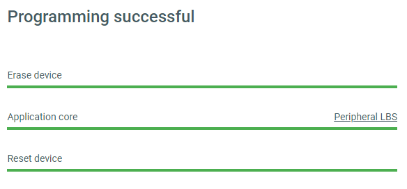

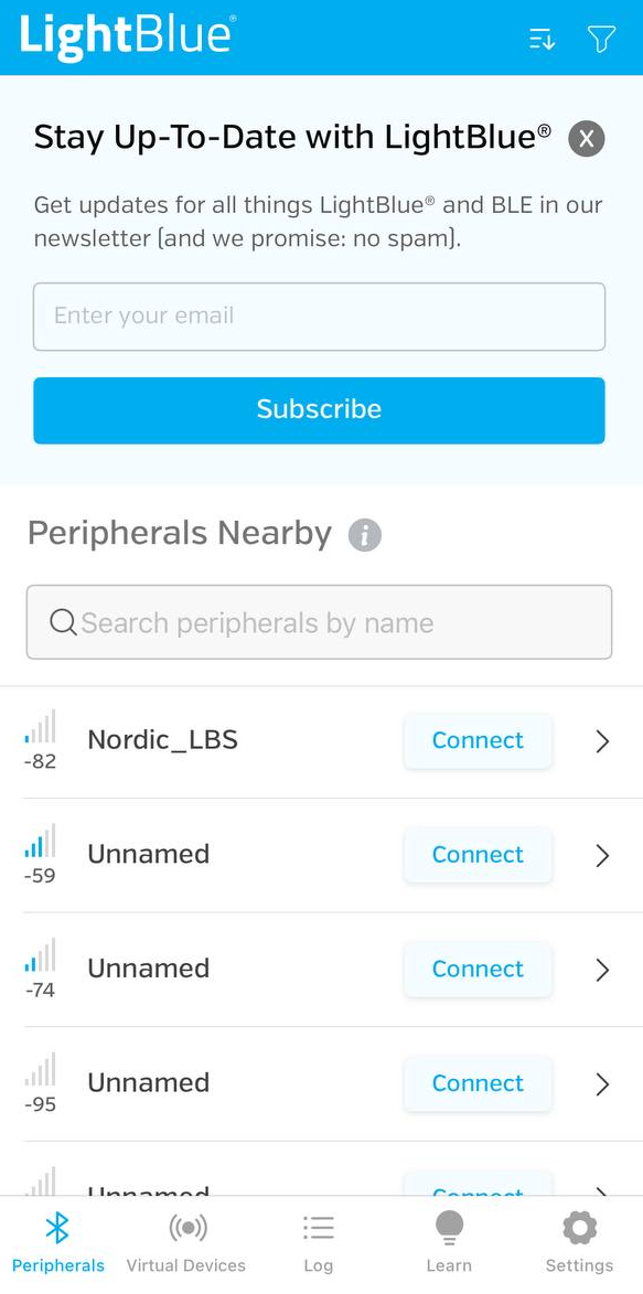

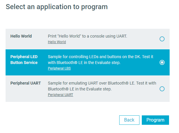

We also tried loading a basic BLE script onto both the evaluation board and the PCB using the nRF Connect for Desktop application. Once again, both boards were programmed successfully, but only the evaluation board seemed to actually be doing anything. In addition, there did appear to be a small difference in the devices' memories
BLE Evaluation Board
BLE PCB
Difference Between Evaluation Board and PCB .hex Files
We have also tried multiple different PCBs and DK boards, and the problems seem consistent across the boards. Overall, we are not sure exactly where to continue debugging, and why the PCB seems to be able to be programmed but not actually run anything?
