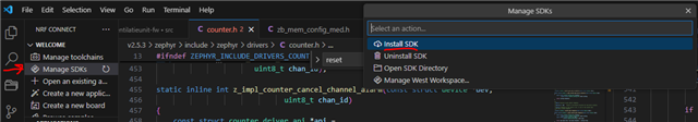

    You have a few options here.
    NB: The link you provided has the different toolchains, not the SDK itself. If you want to download it directly from Git, you can look it up here:
    https://github.com/nrfconnect/sdk-nrf/releases?page=4

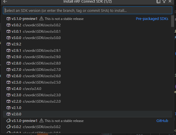

    If you want to, you can also use one of our tools to set it up. Either the nRF Connect for VS Code extension, where you can install it:
    (Note that if you install the SDK this way, you need to also install the toolchain)
    Alternatively, for NCS releases prior to v3.0.0, you can use nRF Connect for Desktop -> Toolchain Manager to download the SDK and toolchain.
    Edvin
