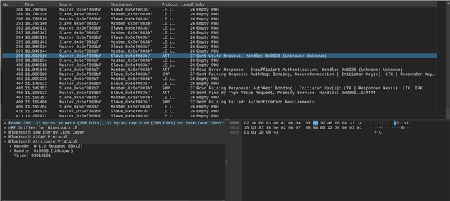

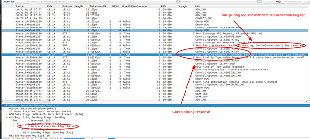

In the sniffer it looks like this:
(Full log from wireshark - gopro13_connection_fail.pcapng)
As far as I understand, the process starts with the packet highlighted in blue. The Master sends an AuthReq, the Client responds AuthReq, but then the master sends "Paiting Failed" with reason:
Opcode: Pairing Failed (0x05)
Reason: Authentication Requirements (0x03)

    Sniffer:
    Opcode: Write Request (0x12)
    Handle: 0x0038 (Unknown)
    Value: 03010101
    Opcode: Error Response (0x01)
    Request Opcode in Error: Write Request (0x12)
    Handle in Error: 0x0038 (Unknown)
    Error Code: Insufficient Authentication (0x05)

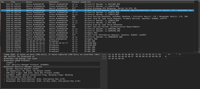

    The nRF Connect SDK / Zephyr samples are now configured to not support the less secure legacy pairing by default. However, the sniffer trace shows that the GoPro does not support LE Secure Connections pairing. Solution to this is to add CONFIG_BT_SMP_SC_PAIR_ONLY=n to your project configuration (prj.conf)
