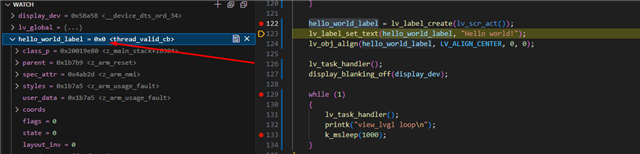

However, after calling:
hello_world_label = lv_label_create(lv_scr_act());
I get a NULL pointer, and any further use causes a crash (lv_scr_act() returns NULL, and lv_label_create() returns NULL).
I assume this happens because no LVGL display was registered, due to the deferred init.

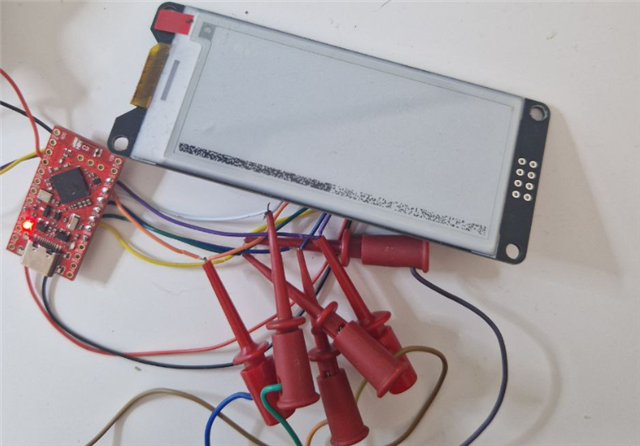

Now I see fast blinking and part of the screen is filled with garbage when initializing.

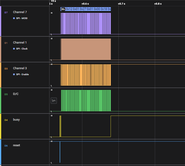

Here is the initialization after power is applied.
        lv_label_set_text(hello_world_label, "Hello world!");

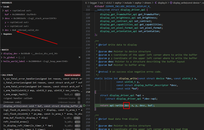

    It seems the crash occurs inside the display driver when LVGL tries to flush the buffer for the first time.
    I did more debugging and found that the crash is caused by a NULL pointer passed to the display driver.
    Just before the crash, in the function display_write() (from include/zephyr/drivers/display.h), the dev pointer is NULL:
    As you can see, when display_write() is called, dev == 0x0 (NULL). This leads to a crash when the API tries to dereference the device pointer.
