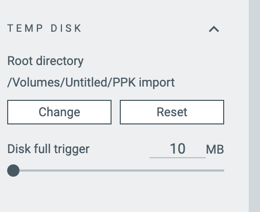

I´m trying to change the installation path of the Nordic Power Profiler as I´m running out of space.
I have about 9GB left, but when trying to open a captured file, Power Proflier says that the file does not fit in the available disk space.
I´ve already change the temp directory but it seems like the Software still relies on space on my C drive.
Is there a way to install the Software on another disk?
Thank you

    • What is the size of the ppk2 file you are trying to load?
    • What is the disk space available on the disk you installed nRF Connect for Desktop?
    • What is the disk space available on the disk where your temp folder is?
    • When is the error happening? A screenshot or record would be very helpful.
    The .ppk2 file contains compressed data, so the application might need a lot more space to load a file. The space requires could easily be more than x5.5 times the file size.

  • Hi, Thank you for the questions.
    The ppk2 file is 684KB.
    I´ve installed Power Profiler on C-Drive. There´s about 8.3GB space available.
    I´ve chosen my D-Drive as a temporary directory, there´s about 167GB available.
    As soon as I try to load the ppk2 file, an error occurs (see screenshot).

    Could you please also share what is the Disk full trigger set to at the moment/when the issue occurs?
  • Yes, that is the file I´m trying to open.
    Disk Full Trigger was set to the maximum of 10240 MB.
    I´ve discovered the following: As soon as I set the Disk Full Trigger to a smaller value (e.g. 3000 MB), I can open the file without a problem. Is this behavior intended?
    It is a bug. The Disk Full Trigger is checked against a different drive. That will get fixed soon.
    Thank you for the report and helping us getting to the bottom of it.
