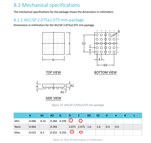

customer is asking the paramter of nPM1100, the min and max of D and E.

Hi
Dimension tolerance is +/-0.03mm for both x and y directions.
Hence for both D and E = 2.075 mm ± 0.03 mm, so the range is 2.045 mm to 2.105 mm.
