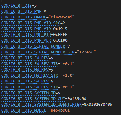

2. Change dis service info

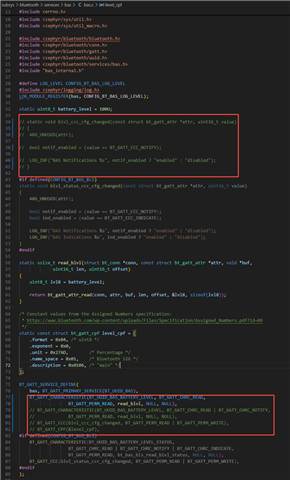

3. Because the notify function of bas service is unnecessary,delete bas_notify();.

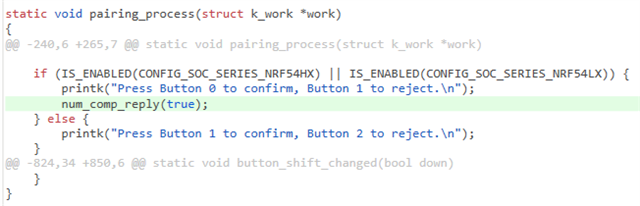

4. The board we are doing authentication on has no buttons, so the binding is successful here.

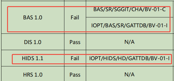

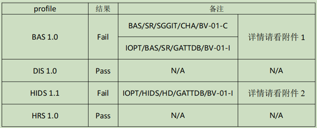

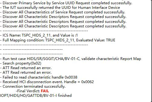

BQB    bas and hid did not pass
BAS
Maybe close bas notify will work. I will do this.

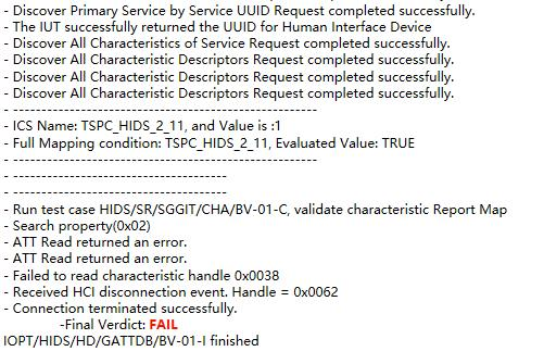

HID
I have no idea to solve this problem.
