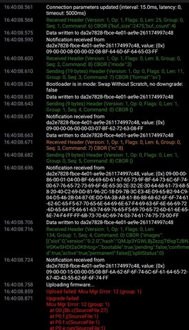

Using the **nRF Device Manager** app, DFU fails with the following:
and on serial terminal
Image index: 0, Swap type: none
mcuimg_img_grp: Irrecoverable error: flash write failed: 12

Attached: screenshots from MCUboot logs, nRF Device Manager output, and error dialog during DFU.
