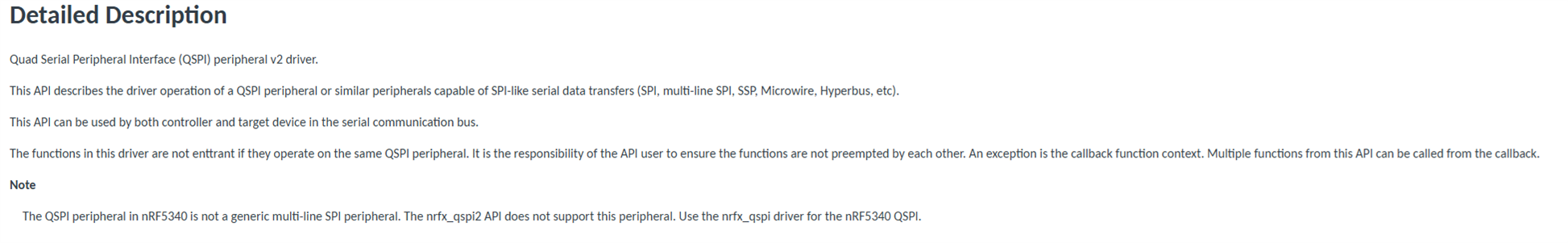

I went through some documentation as I see that the driver and APIs are being changed in the sdk v3.0.1 and onwards in docs.nordicsemi under nrfxlib-apis-3.0.1 I can see a newly added QSPI2 driver and a note specifically for the nrf5340:
It explains to use the nrfx_qspi driver as we did before but now it is not working anymore. Can you maybe guide us on what we are missing so that we can again use the QSPI peripheral on the nrf5340?
