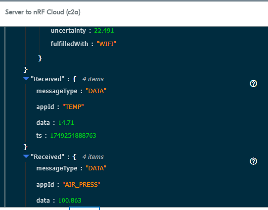

How to get Location data from REST API (Asset_tracking_template on Thingy 91X)
Now, I currently run Asset_Tracker_Template on Thingy91X
https://github.com/nrfconnect/Asset-Tracker-Template/blob/main/docs/common/getting_started.md.
And, I want the location data that shown in the  Server to nRF Cloud (c2a).

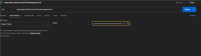

I am currently looking the data from Postman. But, I am not sure about the set up.

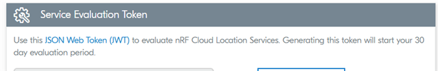

I already have a JWT token as  evaluation period from nrf cloud 's Team panel.
Please provide the correct configuration on Postman. and which  API I have to use.
Thank you
    Please take a look of our API documentation available in https://api.nrfcloud.com/v1/.
    There are many examples how to use REST calls with examples using curl. There is a separate section for location related queries.
    You need to generate API key to use these API calls. You can find it/generate it by going to our portal.
    Go to top right hand-side "hamburger" menu and choose User Account.
    In the middle right there is API Key shown which you have to use to authenticate yourself for location queries.
