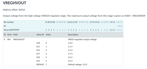

I have a custom board with a nRF5340 and need to configure VREGH in DC-DC mode and set 3.0V output on it.
I see the documentation on REGULATORS — Regulator control where it says:
The VDD output voltage is programmed in the register UICR.VREGHVOUT

I see the VREGHVOUT documentation but am not sure what to do with it:
I also saw this post [nrf5340] Is there a way to set VREGHVOUT to 3.3V before mcuboot runs? but am just running tests and am not using MCU Boot yet, but is this the right/best way to do it?
I read this post on How to use VDDH, DCCH and VDD and see that you set it with NRF_UICR->VREGHVOUT = UICR_VREGHVOUT_VREGHVOUT_3V0; but am not sure where I can set it.
I also see this post How to enable High Voltage Mode of nRF5340 programmatically that you can set it programmatically in main.c.
If you can set the DC/DC registers for VREGMAIN, VREGRADIO, and VREGH using devicetree settings, shouldn't I be able to do the VREGHVOUT the same way?
