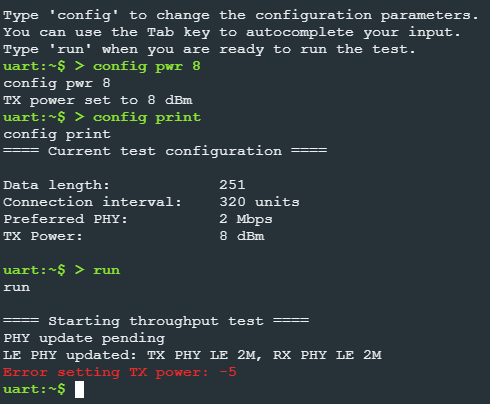

I’m working on a project using two nRF5340-DK boards to measure throughput and RSSI while dynamically changing the PHY and TX power. I started from the official throughput example and added:
  • RSSI measurement (I think this works)
  • A shell command config pwr <value in dBm> to adjust the transmit power, implemented similarly to the PHY-change command
The problem is that power adjustment only works at the default 0 dBm. If I try any other value, the command runs but returns an error, so it looks like my implementation isn’t actually applying the new power setting.
When I set the transmit power to anything other than 0 dBm, I get this output:
Here’s what I’ve changed (all code is available on GitHub):
  1. cmds.c
    • Added a default TX power of 0 dBm
    • Registered the config pwr subcommand in SHELL_STATIC_SUBCMD_SET_CREATE
    • Implemented the pwr_cmd function to parse and store the dBm value
  2. main.h / main.c
    • Declared extern int8_t g_tx_power; in main.h and defined it in main.c
    • Modified connection_configuration_set() to apply g_tx_power to the BLE connection
You can find the full code here:
https://github.com/diegonovo02/prueba_ble
Does anyone know why only 0 dBm works, and how I can get other power levels to apply correctly? Any pointers or fixes would be hugely appreciated!
Thanks in advance,
Diego

    	if (g_tx_power != 0) {
    		    shell_print(shell, "Setting TX power to : %d dBm",
                    g_tx_power);
        struct net_buf *buf, *rsp = NULL;
        struct bt_hci_cp_vs_write_tx_power_level *cp;
        struct bt_hci_rp_vs_write_tx_power_level *rp;
        int err;
        buf = bt_hci_cmd_create(BT_HCI_OP_VS_WRITE_TX_POWER_LEVEL,
                                sizeof(*cp));
        if (!buf) {
            shell_error(shell, "No HCI buffer");
            return -ENOMEM;
    	err = bt_hci_get_conn_handle(default_conn,
    						&default_conn_handle);
    	if (err) {
    		shell_print(shell,"No connection handle (err %d)", err);
    		return err;
        cp = net_buf_add(buf, sizeof(*cp));
        cp->handle_type    = BT_HCI_VS_LL_HANDLE_TYPE_CONN;
        cp->handle         = sys_cpu_to_le16(default_conn_handle);
        cp->tx_power_level = g_tx_power;
        err = bt_hci_cmd_send_sync(BT_HCI_OP_VS_WRITE_TX_POWER_LEVEL,
                                   buf, &rsp);
        if (err) {
            shell_error(shell, "Error setting TX power: %d", err);
            return err;
        rp = (void *)rsp->data;
        shell_print(shell, "Actual TX power: %d dBm",
                    rp->selected_tx_power);
        net_buf_unref(rsp);
    	return 0;

    PS: Max tx-power on nRF5340 is 3 dbm.
                    g_tx_power);
        int err;
                                sizeof(*cp));
        if (!buf) {
            return -ENOMEM;
    	if (err) {
    		return err;
                                   buf, &rsp);
        if (err) {
            return err;
        net_buf_unref(rsp);
    	return 0;
