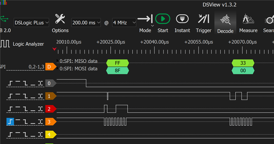

I'm trying to get the LIS2DH12 sensor sample working with the nRF54L15-DK, but I'm running into an issue where the device doesn't seem to initialize properly. Here's what I'm seeing in the console:
*** Booting nRF Connect SDK v3.0.1-9eb5615da66b ***
*** Using Zephyr OS v4.0.99-77f865b8f8d0 ***
Device LIS2DH is not ready
What stands out is the Logic Analyzer data:
This is nothing what looks like the WHO_AM_I which is in fact from the datasheet -> (0x0F). But the response is correct (0x33).

  • Hi Dennis,
    DennisDG said:
    I assume the sample handles the initialization first and then reads the G-force data from the sensor.
    Thanks so much for your help—I really appreciate it!
    Happy to help out, I am glad to hear that you got things working! errors like that in the silk print is not easy to figure out.
    Hope you have a wonderful day!
    Håkon
