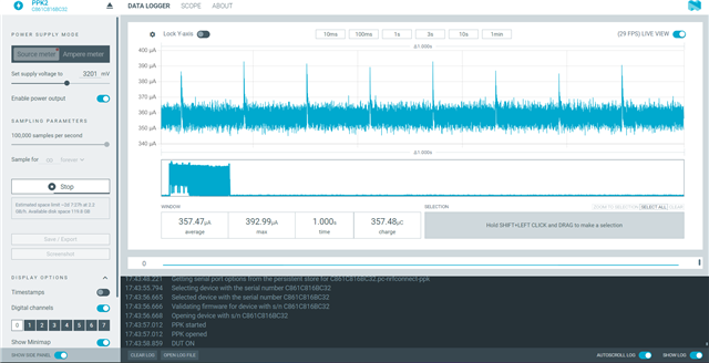

Crash on nrf_pwr_mgmt_shutdown() and high current (~350 µA) in System OFF on custom PCB with E73-2G4M08S1C module

Hello Nordic Support Team,
I am working on an nRF52-based project on a custom PCB using the E73-2G4M08S1C devboard (https://www.cdebyte.com/products/E73-2G4M08S1C).
When I call nrf_pwr_mgmt_shutdown(NRF_PWR_MGMT_SHUTDOWN_GOTO_SYSOFF), the device crashes (error at nrf_pwr_mgmt.c:418), but still enters System OFF mode.
Measured current consumption during sleep remains around 350 µA, which is much higher than expected for System OFF.
Calling sd_power_system_off() directly does not cause a crash, but the current remains similarly high.
Before sleep, I disable peripherals such as SAADC and power off external sensors. The device wakes up via a GPIO button configured as a wakeup source.
SDK version: [e.g., nRF5 SDK v17.1.0]
SoftDevice version: [e.g., S140 v7.2.0]
Board: Custom PCB with E73-2G4M08S1C module
My questions:
  • What are common causes of crashes in nrf_pwr_mgmt_shutdown() and how to avoid them?
  • Why might current consumption stay around 350 µA instead of going lower in System OFF?
  • Are there extra recommended steps to properly disable peripherals or SoftDevice before entering System OFF?
  • Could SoftDevice be causing the elevated current, and what is the best way to handle it?
I appreciate any guidance or best practices to achieve ultra-low power sleep and avoid these crashes.
Thank you!
