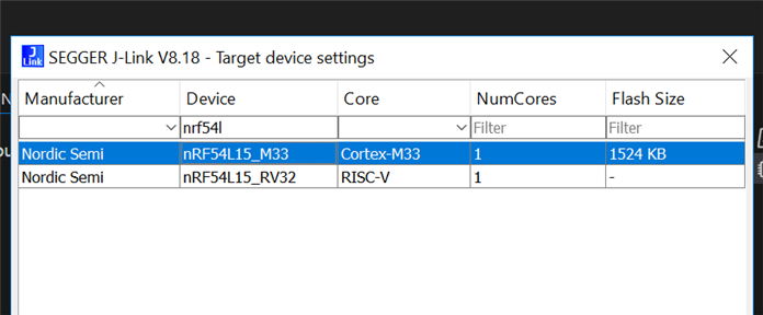

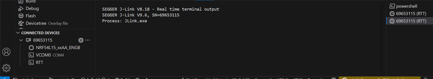

    I'm using SDK NCS 3.0.0. The same RTT configuration that worked on the nRF52832 isn't working on the nRF54L15. I'm able to view logs over the COM port (UART), but not via RTT.
    Even though i tried with ncs 2.9.1 wiith binky example and that is not working with below configuration.
    CONFIG_GPIO=y
    CONFIG_LOG=y
    CONFIG_USE_SEGGER_RTT=y
    CONFIG_RTT_CONSOLE=y
    CONFIG_LOG_BACKEND_RTT=y
    CONFIG_CONSOLE=y
    CONFIG_PRINTK=y
    while (1) {
    ret = gpio_pin_toggle_dt(&led);
    if (ret < 0) {
    return 0;
    led_state = !led_state;
    printk("LED state: %s\n", led_state ? "ON" : "OFF");
    k_msleep(SLEEP_TIME_MS);
    I'm using J-Link version 8.18, and whenever I try to view logs using RTT Viewer in nRF Connect, a pop-up appears asking me to select a board. I select nRF54L15, but the logs still don’t show up.

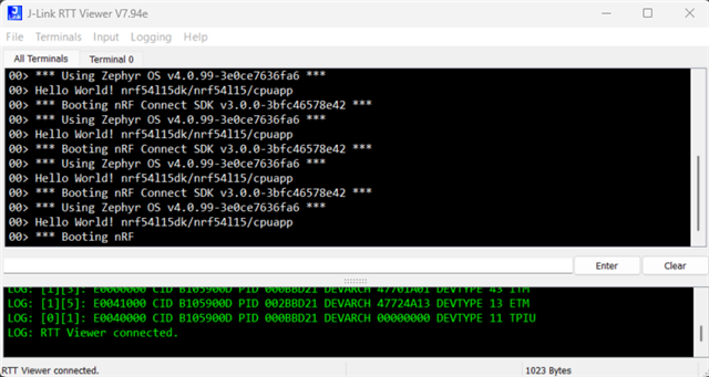

  • Hello Sai,
    I tried the Hello World sample from Zephyr to print output via RTT, and I was able to see the output. I'm attaching the screenshot and the prj.conf file I used for the nRF54L15DK.
    I used the J-Link RTT Viewer instead of the  VS Code extension. I'm not sure what is causing the issue on your end. Make sure one RTT client is active at a time, if more than one tool (e.g., RTT Viewer and VS Code RTT terminal) tries to connect to the RTT, control block simultaneously
    CONFIG_UART_CONSOLE=n
    Kind Regards,
