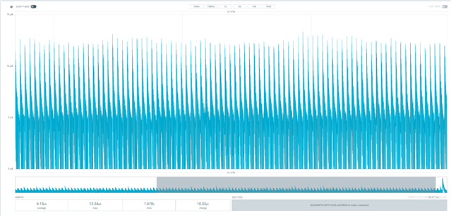

When I don't start broadcasting, there is a 2 ms interval spike in current, as shown in the graph below

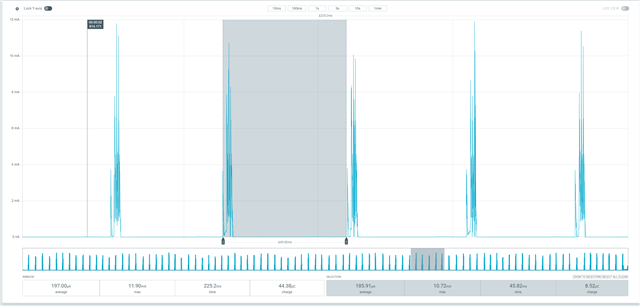

When I enable the broadcast its current is normal as shown in the figure below
    It looks like there is something not quite going to sleep, but waking up every 2ms until you start advertising/broadcasting.
    Is it possible to upload your application here? zip and upload it, so that I can have a look at your main.c file, and the application settings.
    It would be easiest if I could reproduce the issue myself, and then study what's going on.

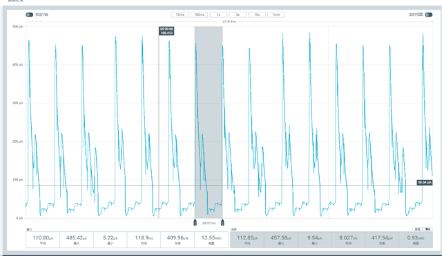

    So I tried taking your application, and starting it looked like expected:
    Then I tried commenting out the advertising:

    And this is what I see:
    So how did you get the behavior as described in your first screenshot? Were you able to reproduce that behavior on an nRF52840 DK?

  • Thanks for the answer, I seem to have solved this issue, I modified the way buzz is driven.
    #define BEEP_STEPS  270
    uint16_t seq_values[BEEP_STEPS];
    nrf_pwm_sequence_t seq = {
    .values.p_common = seq_values,
    .length = BEEP_STEPS,
    .repeats = 0,
    .end_delay = 0,
    nrf_drv_pwm_simple_playback(&m_pwm0, &seq, 1, NRF_DRV_PWM_FLAG_STOP);
    That's the part of the changes I made.
    But I have a question, the boards we produce, using the same set of firmware, some have normal power consumption, and a few have abnormal power consumption. The phenomenon is a wake-up spike in 2 milliseconds.
