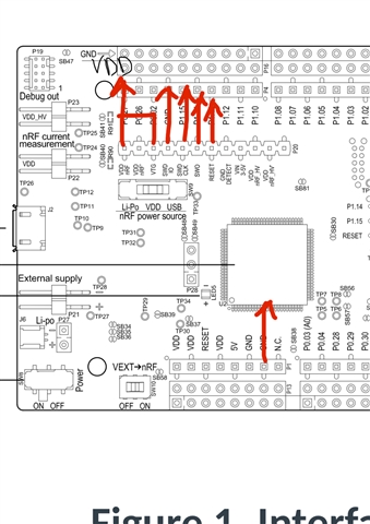

I designed a custom board and now I have to put the code in the nrf52840 module (from raytac). I have been using the nrf52840dk to write my code and now I want to use the board to flash the other one.
This is how I attached my IO pins. The power part is a different page in the desing.
I did notice in many explanations that it said to also connect to detect ground on the dk, but I cannot find that pin.
Can someone help me please? I asked my teacher and he said something about toggling a pin or something, but he was not very specific.
Thanks in advance!
  • Combine/Short nRF_VDD + VTG and connect to your custom board VDD
    SWDIO to SWDIO
    SWDCLK to SWDCLK
    SWO to SWO
    GND to GND
    after this when you open VS Code, under the connected device you will see your DK s Serial number and your custom chips being visible.
    [ To diasable DKs own nRF52840 chip, VTG and nRF_VDD has to be shorted together this enables external chip to be sensed and programmed through SWD. ]
    This is the way to do in nRF5340DK. so give it a try, should be same.
