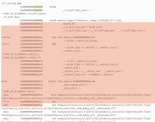

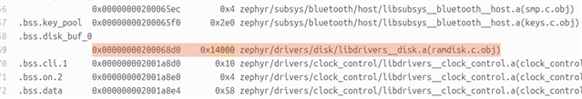

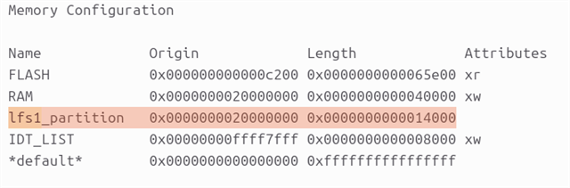

    The issue I'm facing is that each time I try to mount the partition that's supposed to be in RAM, it's the external one that gets mounted instead...

  • Hello Hakon
    I've made a few tests and I have several questions:
      • First, why is the RAM disk size around 64 kB while the partition is only 8 kB?
      • Even with your code, I can see that the linker places some variables/functions between 0x20000000 and 0x20002000. Why is that? Shouldn't the disk or partition configuration prevent the linker from placing anything there?
      • Finally, I can mount the partition, but I can't open or create a file on it — it returns -12 (ENOMEM).

  • I don't know why the linker places stuff in that region, but I will see if I have time to look at that tomorrow.

  • Hello Hakon
    I finally got it working by setting:
    CONFIG_FS_LITTLEFS_FC_HEAP_SIZE=8192
    I'm still wondering why some variables are being linked in the first 80 kB of RAM (0x20000000 – 0x20014000)?
    From build/app/zephyr/zephyr.map :
