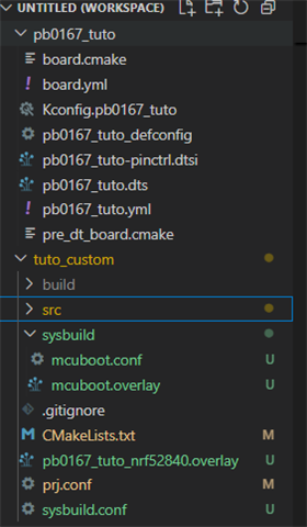

So far, i managed to have two build images (one for the main app and one for MCUboot) and flash them inside my PCB custom board with sysbuild. Using an external button connected to my nRF52840 on my Printed Circuit Board (PCB), when i reboot the board (and hold the external button pressed down), i manage to launch the MCUboot image (i can see that it worked because a LED is configured to be turned ON when MCUboot is in Serial Recovery mode, again following Lesson 9 Exercice 1: Exercise 1 - DFU over UART - Nordic Developer Academy).
My problem comes when i try to connect a USB cable from my USB Type-C connector on my PCB to my computer (when the board is running MCUboot in Serial recovery mode). Nothing is recognised by my computer host (no COM port visible and no audio sound from connecting something in the commputer USB port).

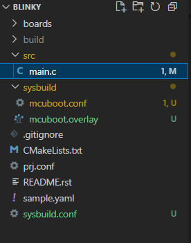

Here is my workspace:
pb0167_tuto is my board file and tuto_custom is the file holding my application (with sysbuild file for MCUboot). Here are the following content of the files on my workspace:

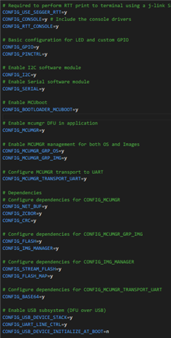

prj.conf:

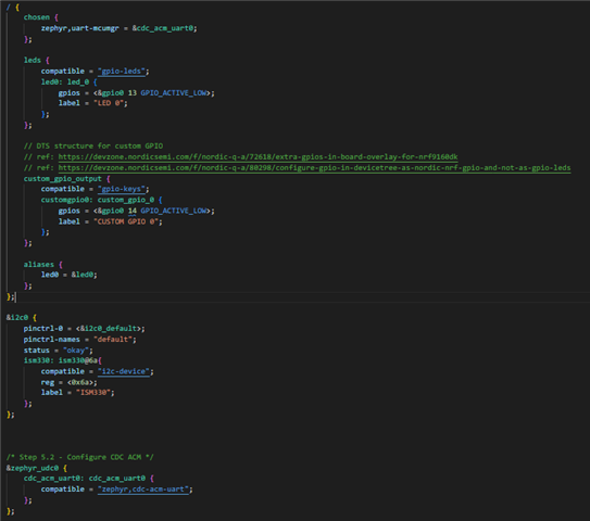

pb0167_tuto_nrf52840.overlay:

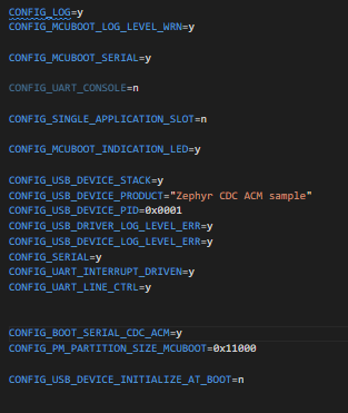

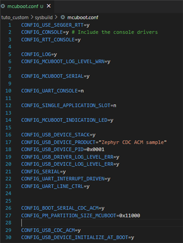

mcuboot.conf:

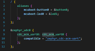

mcuboot.overlay:

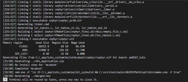

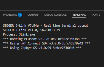

All of the above, when using nRF Connect extensino can be build and results as the following output from VS Code:
My Questions are: If MCUboot seems to be working on my board, why my computer does not recognise the USB on my custom PCB when i connect a USB type-C connector from my PCB to my computer ? Why I cannot see a COM port appearing on my host computer ? Does everything presented hereabove, in my implementation and files, seems right to perform Serial Recovery for DFU over USB using AuTerm (recommanded by nRF in Exercise 4 – DFU over USB) ?

    Second, i implemented the change regarding CONFIG_USB_DEVICE_INITIALIZE_AT_BOOT in the mcuboot.conf file (=y):
    I also included the dependencies CONFIG_USB_CDC_ACM=y and the three configurations:
    CONFIG_USE_SEGGER_RTT=y
    CONFIG_CONSOLE=y
    CONFIG_RTT_CONSOLE=y
    in order to allowed RTT in MCUboot.
    I reckon, correct me if i'm wrong, that enabling CONFIG_USB_DEVICE_INITIALIZE_AT_BOOT=y in my prj.conf (from my main app) is not required since I only want to use the USB Type-C connector (and thus D+/D-) in MCUboot for DFU over USB using CDC ACM ?
    Everything regading the USB configurations that you can see in my prj.conf are configuration "remainders" from the fact that i followed the Nordic Lesson 9 (Exercice 1 and 4) in my first attempt at configuring my USB stack and MCUBoot. In any case, i want to perform DFU over USB from my main application nor having USB capabilities in my main app for data exchange !
    After the modifications in my mcuboot.conf file, and a pristine build, no USB could be detected by my computer. The RTT from MCUBoot displays the following lines but nothing more:

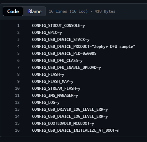

    After browsing some example in the sdk-zephyr github (sdk-zephyr/samples/subsys/usb/dfu/prj.conf at main · nrfconnect/sdk-zephyr · GitHub), i found a dfu example in the samples. Do you think any of the following configuration needs to be added to my mcuboot.conf ? (again, not in prj.conf since USB for my main app is not required):

    mcuboot.conf:
    CONFIG_LOG=y
    CONFIG_MCUBOOT_LOG_LEVEL_INF=y
    CONFIG_UART_CONSOLE=n
    CONFIG_MCUBOOT_INDICATION_LED=y
    CONFIG_MCUBOOT_SERIAL=y
    CONFIG_BOOT_SERIAL_UART=y
    CONFIG_BOOT_SERIAL_CDC_ACM=y
    CONFIG_PM_PARTITION_SIZE_MCUBOOT=0x10000
    CONFIG_USB_DEVICE_STACK=y
    CONFIG_USB_DEVICE_PRODUCT="Zephyr CDC ACM sample"
    CONFIG_USB_DEVICE_PID=0x0001
    CONFIG_USB_DRIVER_LOG_LEVEL_ERR=y
    CONFIG_USB_DEVICE_LOG_LEVEL_ERR=y
    CONFIG_SERIAL=y
    CONFIG_UART_LINE_CTRL=y
    CONFIG_USB_DEVICE_INITIALIZE_AT_BOOT=n

        aliases {
            mcuboot-button0 = &button3;
            mcuboot-led0 = &led2;
    /* STEP 2.1 - Configure CDC ACM */
    &zephyr_udc0 {
        cdc_acm_uart0: cdc_acm_uart0 {
            compatible = "zephyr,cdc-acm-uart";
    For our custom board, we also addded the following node in our board default dts file:
