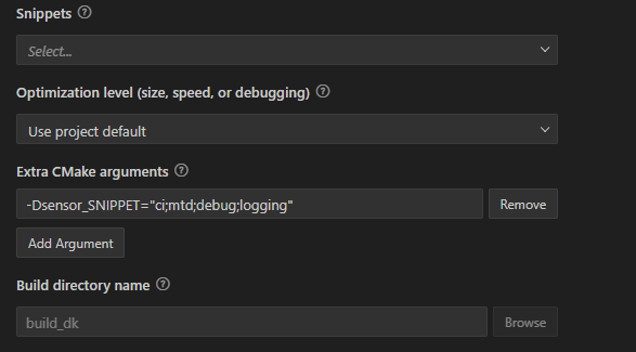

I am adding MCUBOOT to the coap_client example, which inlcudes snippets in the build configuration (ci, debug, logging, mtd).  The snippets are located in the project directory, as in the example.
I followed the steps in the Dev Academy Lesson 9 Exercise 3 to add DFU with external flash.
The compile for mcuboot fails, because it can't find the snippets.  The snippets are for the application code, not mcuboot.

How can I use snippets for the application only, and not mcuboot?
Or do I have to merge them into prj.conf?
