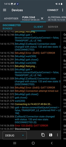

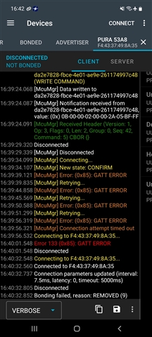

     After using Android nRF Connect FOTA, the settings storage partition of my device was erased, which means that my device's PAIR information was lost and the device cannot be reconnected.

I feel like every upgrade is successful, but I deleted my pair information. After upgrading at the same time, it always prompts GATT ERROR (0X85)

    Are there any changes between the pm_static.yml between your original and your current applicatiion? And what NCS version was the old application based on?
    Also, the gatt error 133 in Android is quite geneic. I don't doubt that it has to do with missing bonding data, but can you please try to capture a sniffer trace when the devices are not able to connect? And for reference, please upload a normal connection (before the DFU). For these, you can use the nRF Sniffer for Bluetooth LE.
