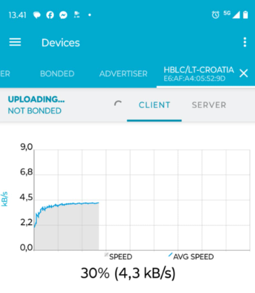

Hello Nordic
Using the old SDK, i was able to do FOTA wiht 10kb/s.
After doing all kinds of tweaks, I am only able to obtain 5kb/s with the new connect SDK.
Can i increase the speed?

  • Hello Vidar, I am using the nRF connect app on my android phone.
    My phone:
    moto g84 5G
    Android version: 14
  • Hello Vidar
    I do not have the k_cpu_idle() command in my code and i do not remember putting the cpu to sleep anywhere in the code.
    I have captured the FOTA event using wireshark:

    k_cpu_idle() turned out to be the culprit in the other case, but this is a function that normally should not be used at all in a multi threaded app. The question is whether you have any threads or other components in your application that might be blocking the workqueue. Have you tried to debug the application to see if the app is allowed to enter the idle thread? Do you have debug logging enabled?
    WS trace looks similar to the one posted in the other thread.
  • Hello
    Yes I was blocking the workqueue, doing to mush work in main and not releasing the thread.
    After adding this code, i have increased to FOTA speed to 10kb/s
    static atomic_t is_bootloading = false;
    /* 1. event handler ------------------------------------------------------ */
    static enum mgmt_cb_return dfu_cb(uint32_t event,
                                      enum mgmt_cb_return prev,
                                      int32_t *rc, uint16_t *grp,
                                      bool *abort_more,
                                      void *data, size_t len)
        switch (event) {
        case MGMT_EVT_OP_IMG_MGMT_DFU_STARTED:
            atomic_set(&is_bootloading, 1);
        case MGMT_EVT_OP_IMG_MGMT_DFU_STOPPED:
        case MGMT_EVT_OP_IMG_MGMT_DFU_CONFIRMED:
            atomic_set(&is_bootloading, 0);
        default:
        return MGMT_CB_OK;              /* always allow DFU */
    /* 2. mcumgr callback registration object -------------------------------- */
    static struct mgmt_callback dfu_cb_reg = {
        .callback = dfu_cb,
        .event_id = MGMT_EVT_OP_IMG_MGMT_DFU_STARTED |
                    MGMT_EVT_OP_IMG_MGMT_DFU_STOPPED |
                    MGMT_EVT_OP_IMG_MGMT_DFU_CONFIRMED,
    /* 3. tiny init routine that runs at boot -------------------------------- */
    static int dfu_cb_init(const struct device *unused)
        ARG_UNUSED(unused);
        mgmt_callback_register(&dfu_cb_reg);
        return 0;
    /* 4. ask Zephyr to call it at the APPLICATION init level ---------------- */
    SYS_INIT(dfu_cb_init, APPLICATION, CONFIG_APPLICATION_INIT_PRIORITY);
    Then i am using the is_bootloading variable to suspend tasks in my main loop.
        while (1) {
            if (atomic_get(&is_bootloading))
                wdt_feed(wdt, wdt_channel_id);
                toggle_all_leds();
                k_sleep(K_MSEC(100));
                continue;
    Does this way of suspending seem good code practice to you?
    I have not yet suspended the display update, I asume suspending the display, might bring me up to 20kb/s.
    Good to hear that you are getting better speeds now.
    I don't see anything wrong with your approach, but it sounds like your app spends most of its time processing tasks in the main loop, which also means the system isn’t able to spend much time in sleep. Are the tasks in this loop really that compute heavy and need to be blocking, or could the main loop perhaps yield more often?
  • Yes, we had not paid much attention to the multithreaded nature of the Zephyr RTOS. We could definitely yield more frequently. Thank you for helping us realize that the main issue was the lack of frequent yielding, rather than the settings in the .conf file.
