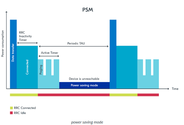

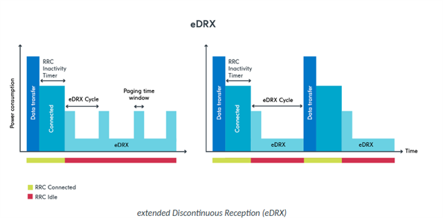

1.As shown in the following PSM eDRX figure, during the red period, how will the text messages sent to nRF9160 be processed? Will the nRF9160 module receive them in the next green period?
2. Why can't customers receive SMS messages during the red period but not during the green period when they are tested with China Mobile's CMNBIOT?

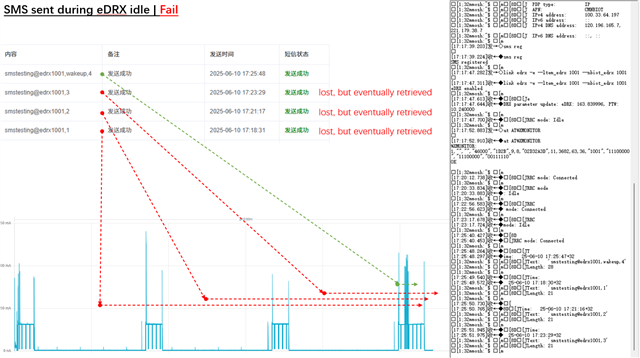

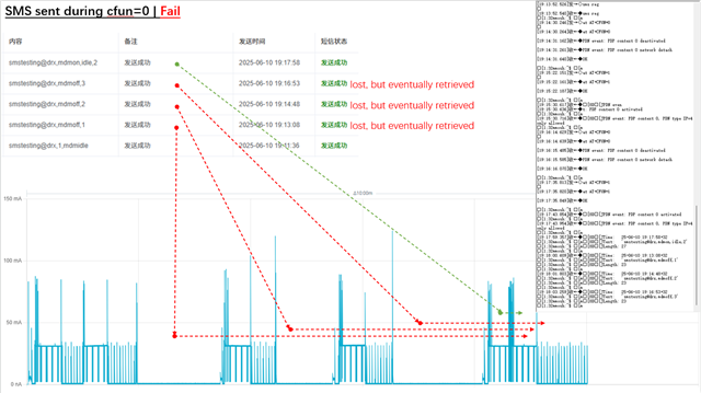

    2, Similarly, while no edrx/ no psm, if SMS was sent druing cfun=0, we still could not receive SMS druing cfun=1. However, if we sent one more SMS druing cfun=1, then we can receive all previously missed SMSs. Please refer to below

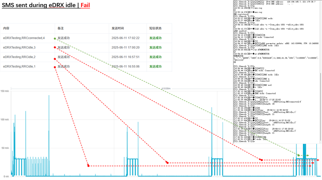

    2nd round SMS testing @ eDRX, please refer to the attached LOG & image
    Please help to understand what problem is. Thanks.

    [16:53:14.258]发→◇sms reg
    [16:53:14.276]收←◆sms reg //enable SMS
    SMS registered
    mosh:~$
    [16:53:27.925]收←◆RRC mode: Idle
    mosh:~$
    [16:54:12.346]发→◇link edrx -e --ltem_edrx 1001 --nbiot_edrx 1001
    [16:54:12.371]收←◆link edrx -e --ltem_edrx 1001 --nbiot_edrx 1001 //enable eDRX
    eDRX enabled
    mosh:~$
    [16:54:12.670]收←◆RRC mode: Connected
    mosh:~$
    [16:54:12.849]收←◆eDRX parameter update: eDRX: 163.839996, PTW: 10.240000
    mosh:~$ RRC mode: Idle //1st SMS sent during RRC idle @16:55:06+32
    mosh:~$
    [16:54:20.602]发→◇at AT%XMONITOR
    [16:54:20.621]收←◆at AT%XMONITOR
    %XMONITOR: 1,"","","46000","1D2B",9,8,"02D32A3D",11,3682,61,38,"1001","11100000","11100000","00111110" //check eDRX
    OK
    mosh:~$
    [16:56:44.354]收←◆RRC mode: Connected
    mosh:~$
    [16:57:05.481]收←◆RRC mode: Idle //2nd SMS sent during RRC idle @16:57:51+32
    mosh:~$
    [16:59:28.198]收←◆RRC mode: Connected
    mosh:~$
    [16:59:49.326]收←◆RRC mode: Idle //3rd SMS sent during RRC idle @17:00:20+32
    mosh:~$
    [17:02:12.042]收←◆RRC mode: Connected  //4th SMS sent during RRC connected @17:02:22+32
    mosh:~$
    [17:02:24.970]收←◆Time:   25-06-11 17:02:22+32
    mosh:~$ Text:   'eDRXTesting,RRCconnected,4'
    mosh:~$ Length: 26
    mosh:~$
    [17:02:26.290]收←◆Time:   25-06-11 16:55:06+32
    mosh:~$ Text:   'eDRXTesting,RRCidle,1'
    mosh:~$ Length: 21
    mosh:~$
    [17:02:27.479]收←◆Time:   25-06-11 16:57:51+32
    mosh:~$ Text:   'eDRXTesting,RRCidle,2'
    mosh:~$ Length: 21
    mosh:~$
    [17:02:29.434]收←◆Time:   25-06-11 17:00:20+32
    mosh:~$ Text:   'eDRXTesting,RRCidle,3'
    mosh:~$ Length: 21
    mosh:~$
    [17:02:51.229]收←◆RRC mode: Idle
