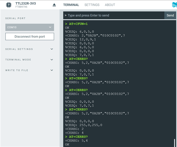

Hi I created a custom board with nRF9160SiP
I follow the same schematic og Thingy:91
I ran some tests with VNA to see if the antenna matching was correct, and I see that I have a VSWR of 2.5:1, so it should be fine.
The problem occurs when I run the following commands:

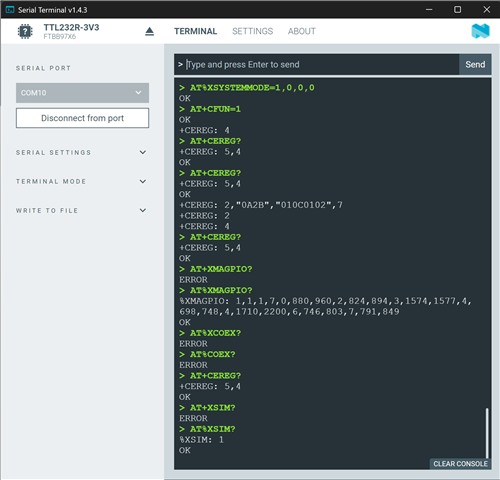

  • Hi, I found the problem. The confugartion of MAGPIO are wrong.
    I invert MSB with LSB.
