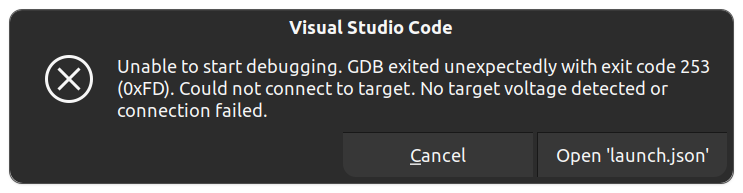

GDB exited unexpectedly with exit code 253 (0xFD).

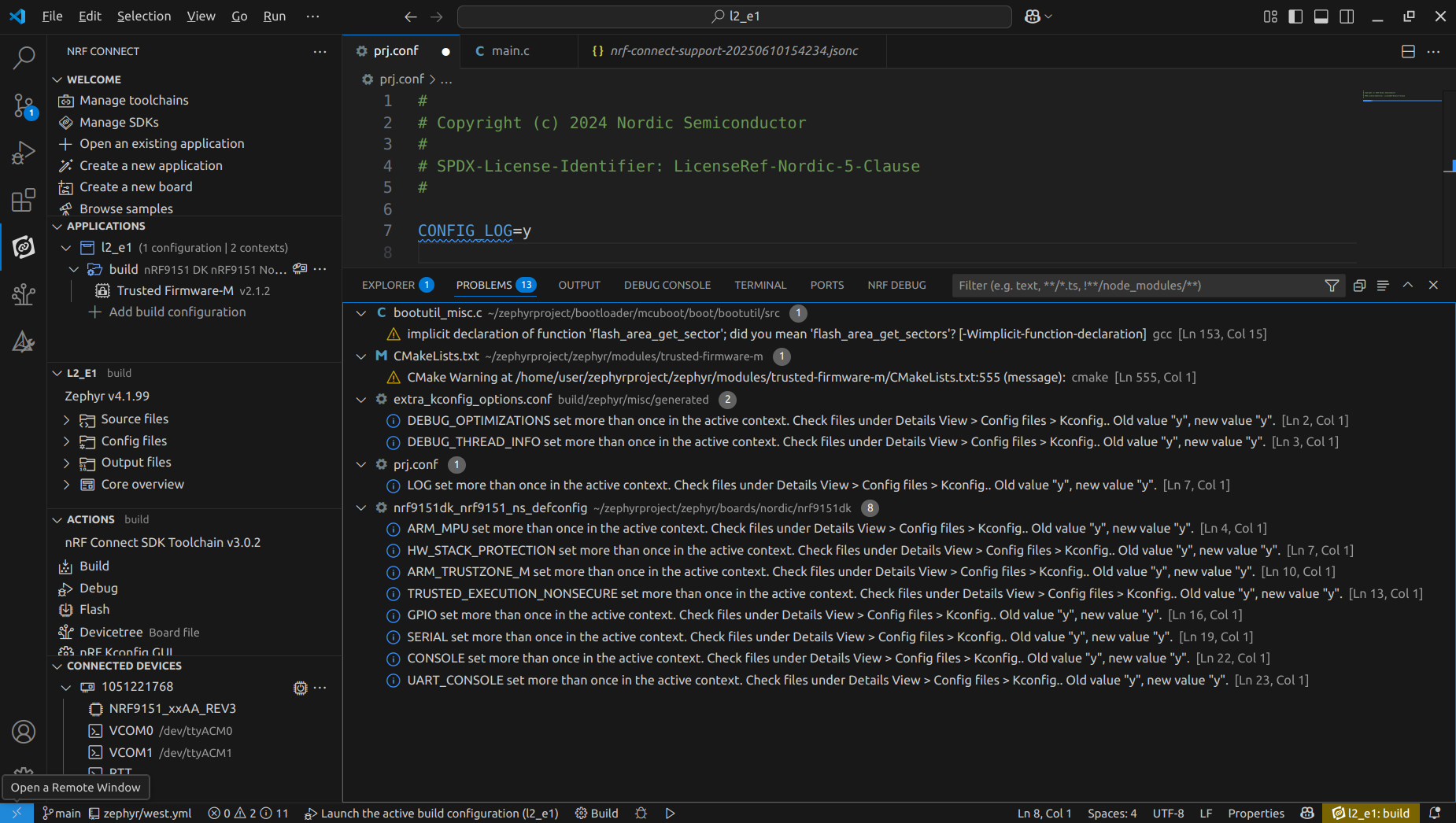

Build configuration is set as follows:
SDK:  Zephyr v4.1.99
Toolchain: nRF Connect SDK Toolchain v3.0.2
Board target:  nrf9151dk/nrf9151/ns
Optimization level:  Optimize for debugging (-Og)
After the build files are generated, it looks like this:
After selecting "debug", which should burn the build on the board and begin debugging it, I get the following error message:
Just as a side note, this appears to be a problem with the debugger.  I have not had problems flashing code to this board.

  • Dear Colleagues,
    Strangely, I got a sort-of workaround going today.  I upversioned to JLink V810i (nrf-connect wanted V794i).  Then, after building with "Optimize for debugging (-Og) enabled in the configuration, I edited bootutil_misc.c to correct line 153.  A problem with this file is shown in the "problems" window:   implicit declaration of function 'flash area_get_sector'; did you mean 'flash_area_get_sectors'?[-Wimplicit-function-declaration] gcc [Ln 153, Col 15]
    I simply edited the file inline and hit "debug", the trusted firmware version flashed and now I am proceeding with the lesson. I did not rebuild.
    I believe this will be a consistent problem with each future "debugging enabled" build, since bootutil_misc.c appears to be generated as part of the build.
    At least I can proceed with this lesson, though and seem to have identified a temporary workaround. It will be interesting to see what happens the next time I have to use the debugger-- or the next time I start VS.
    Thanks,  sonic4

  • Hi Sonic4,
    Seems liike there are two issues that you are seeing. The debugger seeems to be failing mostly due to the target voltage being low or not detected which could be a hardware or USB issue.
    The second problem seems to be that your TFM generated files seems to use an outdate function (flash_area_get_sector) which might not be available in the SDK version you are using. Are you sure you are using the same SDK version suggested in the lesson?
